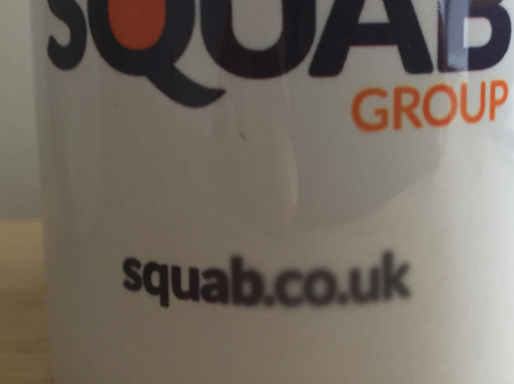

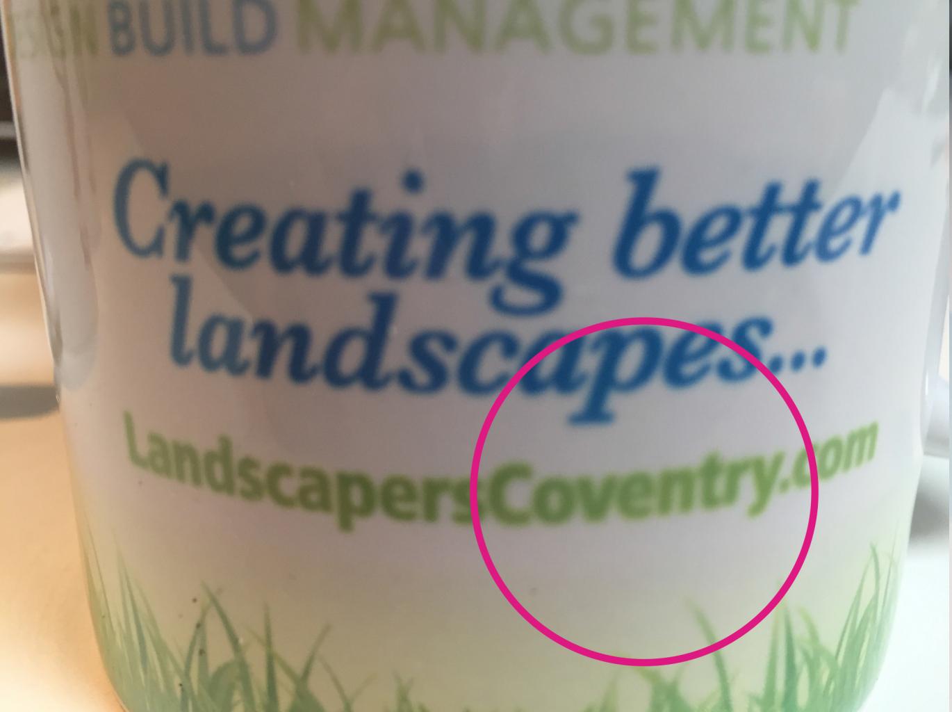

Hi Paul. Here are some examples:
- vB_ID:3989
- Example 3.jpg (76.64 KiB) Viewed 671 times
- vB_ID:3988
- Example 2.jpg (76.84 KiB) Viewed 671 times
- vB_ID:3987
- Example 1.jpg (75.96 KiB) Viewed 671 times

As a novice to this game, seeing blurry patches on every mug I’ve produce on varying time/temp/pressure has made me wonder if the problem is occurring because of the mug press itself. I guess i’m just looking for is some reassurance. If the blurry patches are typical when testing then that’s fine, I will persevere (and perhaps buy a box of better quality mugs to try). But if it could potentially be a problem with the heat press then I would rather try a different press and stop wasting my efforts on the Freesub one.
Having had a close look at the press it looks to me like the clamp doesn’t sit perfectly across the face of the mug, or in other words there are certain areas where the mug does not seem to be clamped as tightly as others. Could this be causing the issue? Does it matter that the clamp it’s not perfect all the way around?

Have you turned the mug the opposite way in the press yet? This will help figure if it is the press. If the blurred part is then at the top you know it is that part of the press.
Secondly, as the problem print area is around an inch from the bottom you need 5o check the mug. Get a ruler or straight edge and place it up the side of the mug. Make sure this is vertically over the faulty print area as well. Look at it side on and see if the contact from mug to ruler is consistent. Blurry patches could be due to a dip in the mug as an alternative to the press.
The press should really be fitting neatly around the mug and look like it is closing squarely rather than any angle. When mug is in and secure you need to get down to that level and look at either side to see how the element is touching the mug as pressure should be exerted all of the way around.

It may be possible to put a thin strip of paper between the element and mug, clamp it and see if the paper can be pulled out. Repeat for the whole mug and it will tell you if there is a problem.

I've got mine working a treat now, I was getting some weak areas at the bottom of the mug and no matter what I did it was always the same
UNTIL:
i now now fold a bit of paper until about 3mm thick and tape it to the bottom of the mug so when it activates the press, the mug sits slightly higher and I get a good full print.
