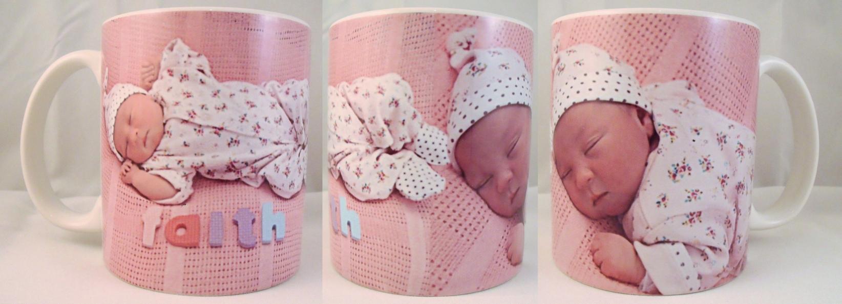

I use one, I do 360sec @190c. When you turn it on and hit heat up do you hear fan noise? I only ask as back when these came out there were a few people who didn't and that was because the machines they had were faulty.

Yes I get a fan....really 360 does it give u a good transfer?

I believe paul has/had one of these machines as well but was using a lower temp and a longer time than me and there was someone else who modded theirs to do it quicker than 360secs but I don't know what they did to mod it.
Also I would recommend putting a blank bit of paper between your print and the wrap to protect the wrap from the ink.

Damn thats fantastic...ill try again thanks.
