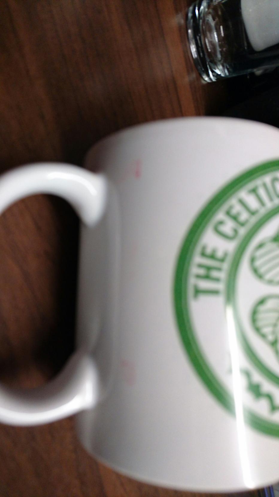

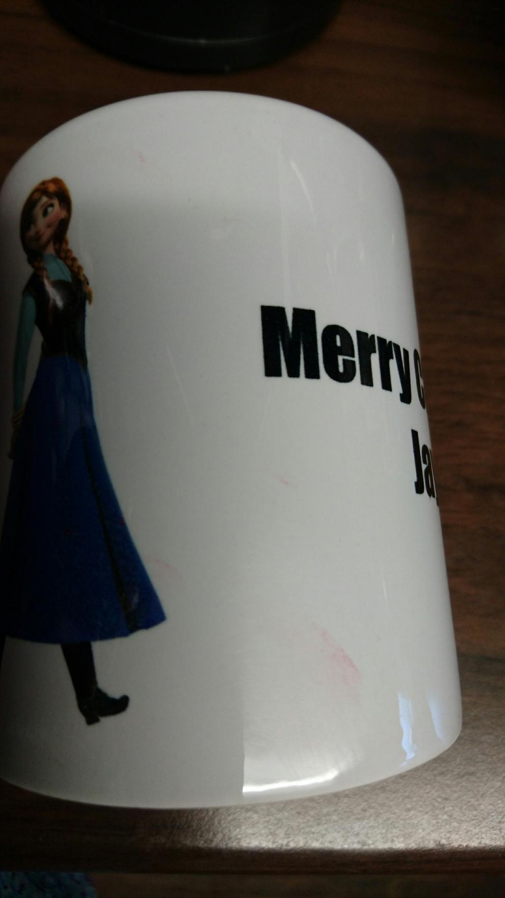

Has anyone come across this before? It was first showing at the edge of the images and I thought it was from the heat tape, but it is now showing mid image. It's not showing up on the paper prior to printing or even after, just on the mugs. I know it's not the mugs as I've tried 2 different types. It won't rub off either, a friend has suggested nozzle heads may be blocked or need cleaning so I will look at that although it is a new printer so hopefully not. I have attched thumbnails to this post (if I did it right)
Sorry for the poor quality images, these mugs are being done for personal use not for sale. Thanks in advance.

Ok, as no one has any suggestions I thought I'd post my findings in case anyone else has similar issues in future. I did a lot of sitting in front of youtube vids and forum searching and I think it may be down to Gassing, when the ink manages to blow from where it should be to another spot on the mug. Strange that it always seems to be red....I have altered my print area by 1cm so that the ink isn't too close to the edge of the paper, cleaned my print heads just in case, lowered my temp by 5 degrees to 185 for 170 seconds (might go down to 180 for 180 out of curiosity) and I was dunking my mugs in warm water then drying them to warm them before printing and I have stopped this and just make sure my mugs are at room temp in case moisture was an issue.
The result is; 2 mugs were perfect, no red streaks at all. The third had a teeny red smudge and the only difference was that the paper did not cover the mug from top to bottom, it was more like a strip across the middle of the mug so I think contact with the mug may have been an issue.
As a complete newbie I may have come to the wrong conclusion about gassing but the problem although not solved is much better.

It doesn't look like gassing. The red marks are to prominent and in specific areas and you have no red on you Celtic or Frozen designs. They look more like transfer from ink on the element possibly but on the Frozen design it would need to have gone through the paper which would be unusual. Would need more info really on what the used transfer looks like. An additional larger paper wrap might help around the mug to protect it. Give the element a Good wipe when it is warm as well.
