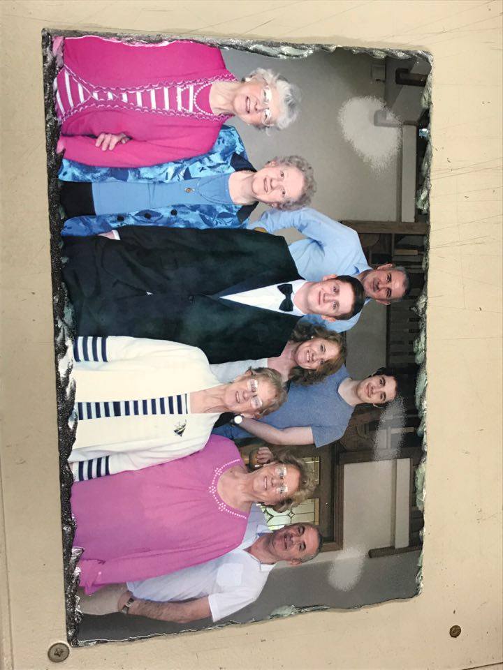

Photo Rock slate is not transferring properly.Paper sticking to slate.
Products/Equipments:
[TABLE="class: custom-data]
[TR]
[TD="bgcolor: #E4F1D8]Ricoh SG7100DN, Xpres A3+ Paper, Sublijet r ink, Rock Slate,[/TD]
[/TR]
[/TABLE]
What I have tried to resolve problem:
I have tried changing the temperature, the time and pressure slightly as suggested by other sights.
Ensured print was dry on paper before pressing.
Pre-cooking slate to ensure no moisture.
Used silicone pad.
Slate is face up, print face down.
Made sure printed on correct side of paper.
[TR]
[/TR]
[/TABLE]
Used silicone pad.

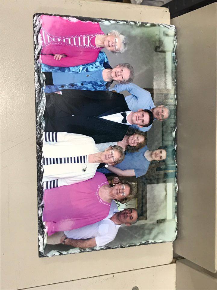

Yes, I have similar results - are these a new batch of slates recently? All the newer ones I'bve tried to print have come out like this.
Re: Photo Rock Slate Blotchy
Got my first batch 9th Oct for testing got second batch 27th Oct. You can see the first batch are far more glossy looking.
I had a matte in the first batch and it was the best by a long way.
I got them from Merlin Transfers and will be contacting them soon!
