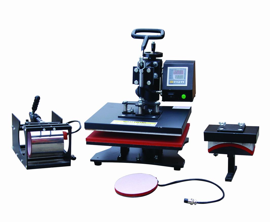

Is you press a Combo press, where all the individual presses use the same controller? I'm thinking it might be a controller fault, but just guessing.
Ger
Posts: 7
Joined: 05 Apr 2017, 13:32
Re: Colours not right after Heatpress. Help!
Post by Ger »
Combo press? Excuse my lack of knowledge on this, but I don't know what you mean. Thanks.
Sorry. A Combo press has different presses for different things but they all use the same controller. Like this...
[ATTACH=CONFIG]4556[/ATTACH]

Ahh! No, I use a Sefa Press. Just does what it says on the label! No combo.
