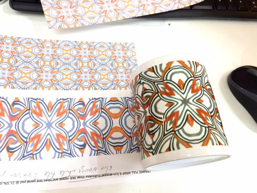

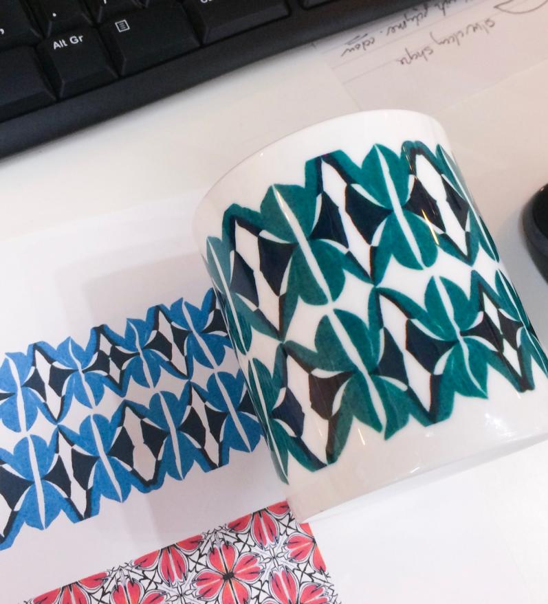

Hi folks - relative newbie - just wondering if anyone could shed any experienced light on this, as it's driving me nuts! See images.
Colours are mostly OK, but blues turn green or greeny grey. Happens with bone china and ceramic.
I'm waiting on a custom ICC profile from Paul, so currently using the Epson profile which seems to be the best / most accurate (apart from this issue).
BUT I'm wondering whether it's my time or temperature?

Your images point to the ICC profile. I suggest you wait until you have this installed and then try again.
What the image looks like on the dye sub paper will have no relation to what the actual printed colour will look like.

Thank you, that's reassuring... I have been experimenting with times etc, but don't want to ruin more than I have to!
I realised after I'd posted the orange / grey image that the offending mug is actually shown alongside a "normal" print - ie not subli ink or paper.
Bizarrely, tho, the subli inks are fairly true to the normal inket before they are sublimated (a bit washed out looking but otherwise similar) hence me wondering whether it was something I was doing wrong in the heating process.
Will wait (not very patiently...) for Paul to do my profile.
