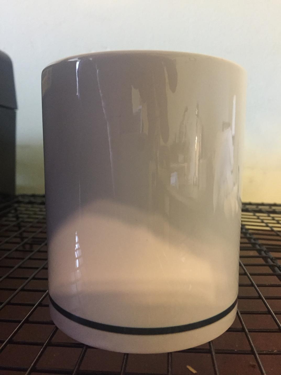

I think the main person at fault here is the customer.
Looking at the full set of photos uploaded I can't see what was so unacceptable about those prints. I have a cupboard full of mugs we've bought over the years for use in the home with many worse than your examples, yet never given them a second thought. I can hold many of them together and they aren't straight sided, a true straight sided mug is a rarity.
So yes, maybe time to put it down to experience and draw a line under it............. but preferably not a green one! :wink:

I think the mugs are acceptable. It is a tricky design where you have a perfectly straight line hovering 5mm above the base. No hiding place for any error. The original photos posted looks like the print is kicking out the opposite way.... down in the corner.
The whole process is done by hand and not machine. Paper cut by hand and positioned by hand. The mugs are generally cheap items and as mentioned with others, it is not a precision process, just as near as possible.
We print quite a lot of the different China mugs. As it is far lighter weight a product with thinner body we know to expect barrelling and tapering to the base. Putting a straight pine across the lower part of the mug results in a slight smile, so takes some adapting to get right.

At first I thought they looked fine, but if you turn the picture they actually look worse with the mug the right way up than they do horizontal. I wouldn't be over the moon with that result I don't think.

I have printed on two of the four mugs sent. One I did for a mate as a birthday present. I did tell him that the mug was a sample and should it fade or deteriorate in anyway then to let me know. I will report back should he say anything. The other one I printed as the picture shows. No adjustment to the artwork and wrapped the same way I wrap any mug. I have measured the line at several points and the variance is less than .5mm. It is fair to say this could be my wrapping, and I certainly think it is well within the standards I expect.

Fair play to your honest review. I wont knock it at all. The mugs that I had were the 10oz. I have again tried with a design of my own but still cant get a full wrap straight. I will pop a picture or 2 up shortly.
Edit, no I wont as it contains NSFW material. I dont know why, I just cant seem to get the wrap to sit right
