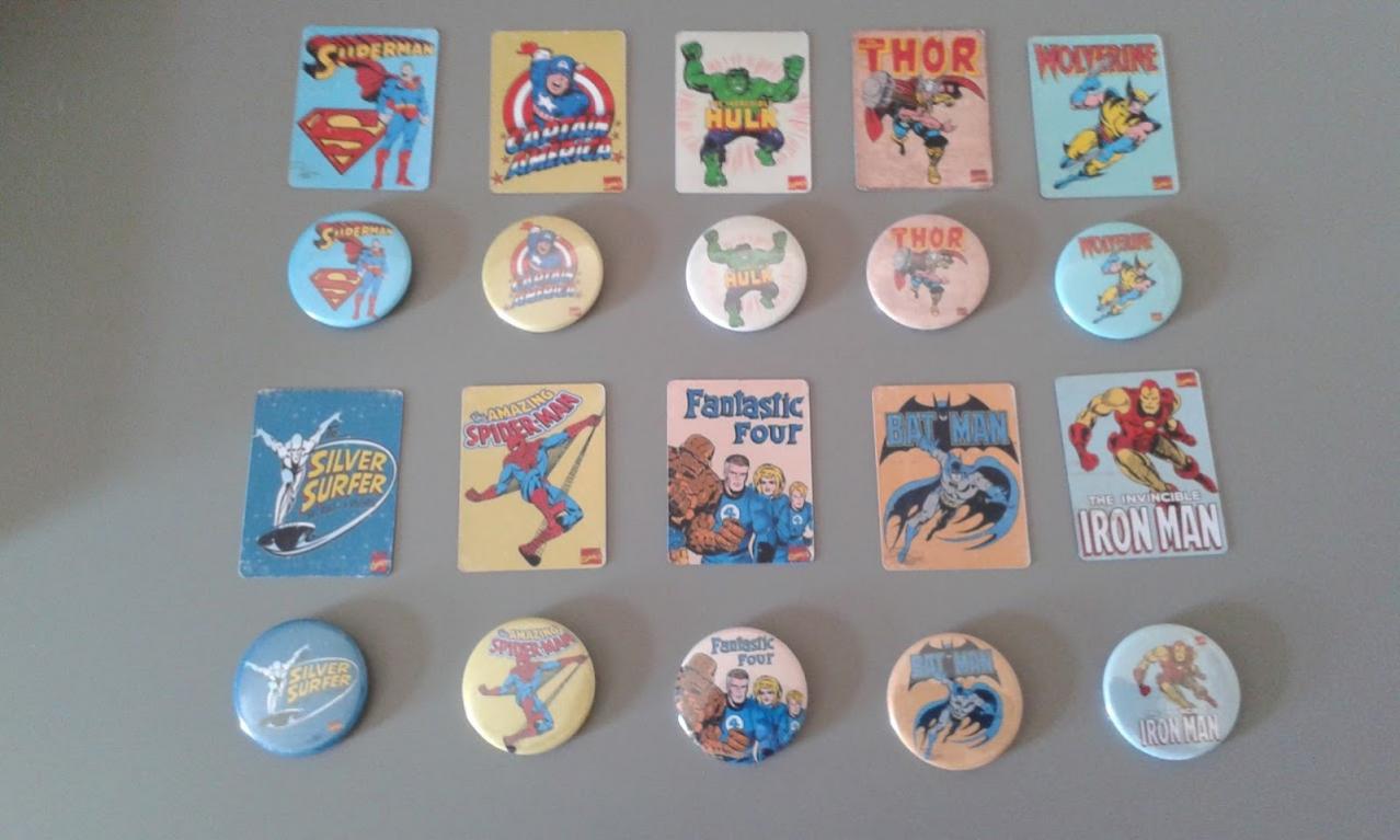

And a Retro Superhero badge and fridge magnet set I made for my nephew -
