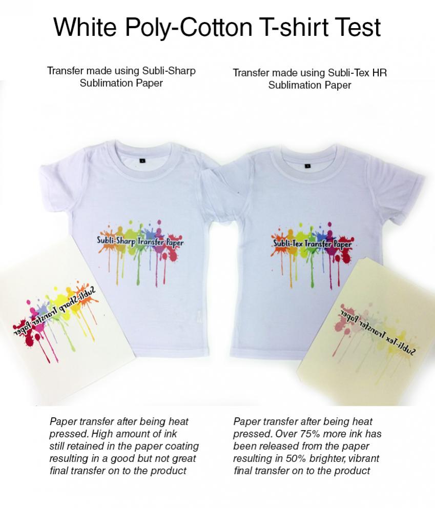

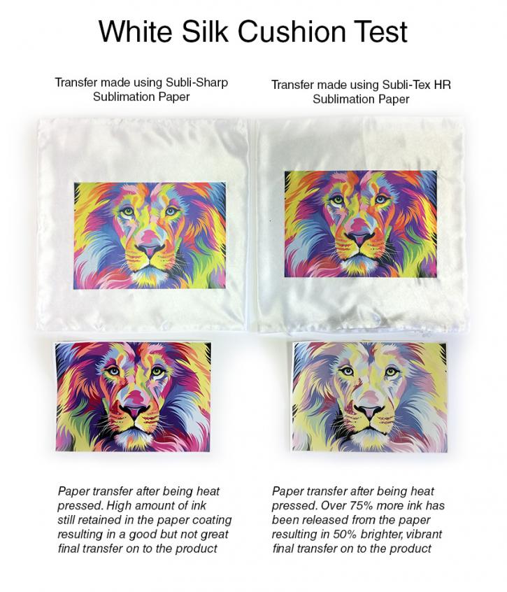

As a few others have said, try a high release paper. I supply two papers - Subli-Sharp and Subli-TEXTILE.
Subli-sharp is for hard substrates - metal, ceramic woods. It does work on fabrics but not as well as Subli-TEXTILE
Subli-TEXTILE as the name suggests is for textiles and fabrics. It releases almost double the ink of the Subli-Sharp paper leaving a more vibrant image transfer.
Here are a couple of tests we did with both papers to show the differences that can be achieved - same printer, same ink, just different paper.
