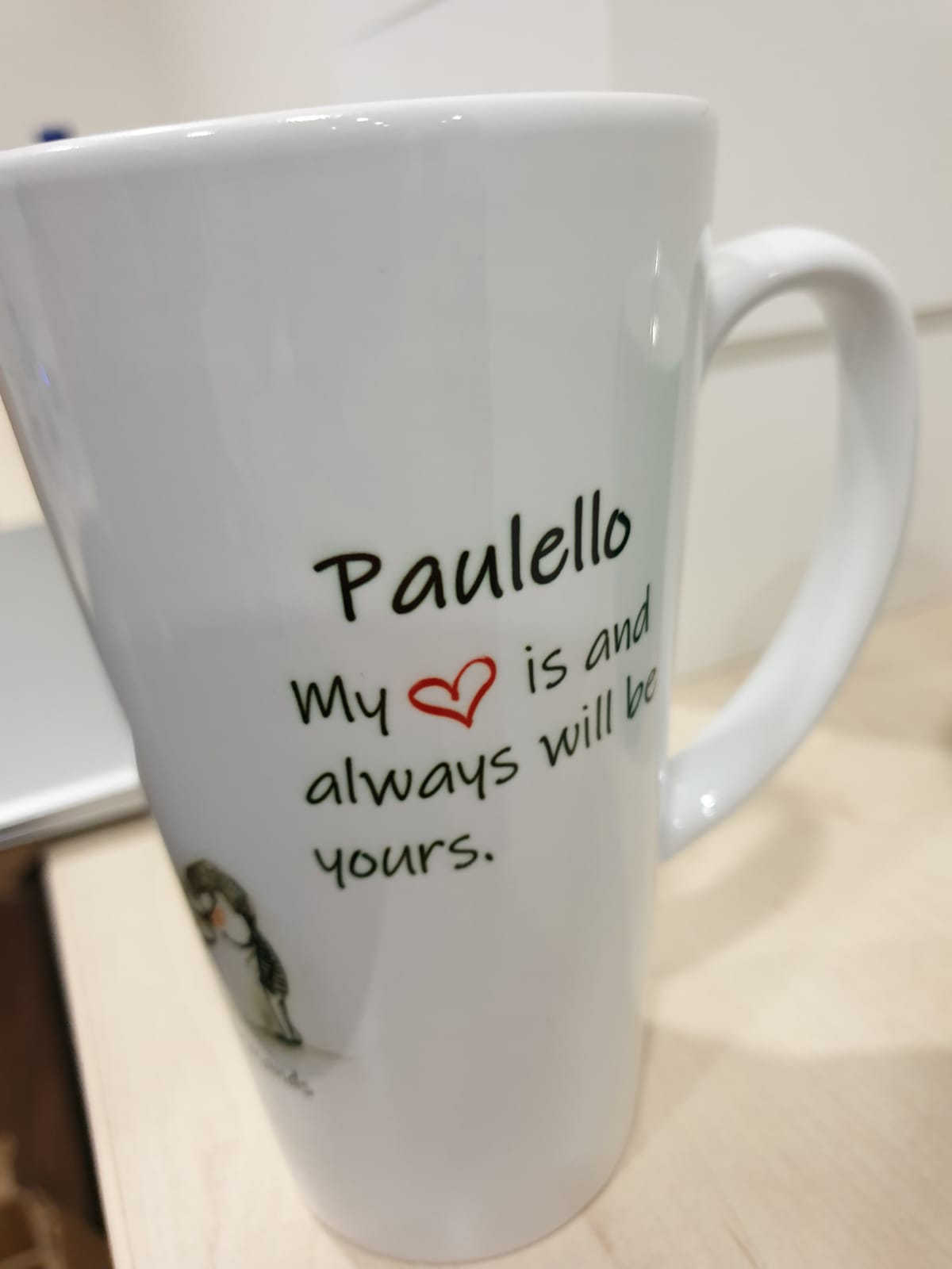

I got problem that there is yellow line a round black color:
vB_ID:5594
vB_ID:5594
So this mean that I use too high temperature? I use 360F to 180sec.
Maybe I got yellow line because I use regular cooking paper not specialized?
Also, could you please explain the point of dunking mugs? I have found many opinions on this. Do you find big difference between dunked and non-dunked mugs?
Have you tried to sublimate anything on latte mugs? I found out that you must have special design because mug is narrow on the bottom but wider on top.
