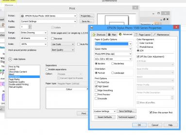

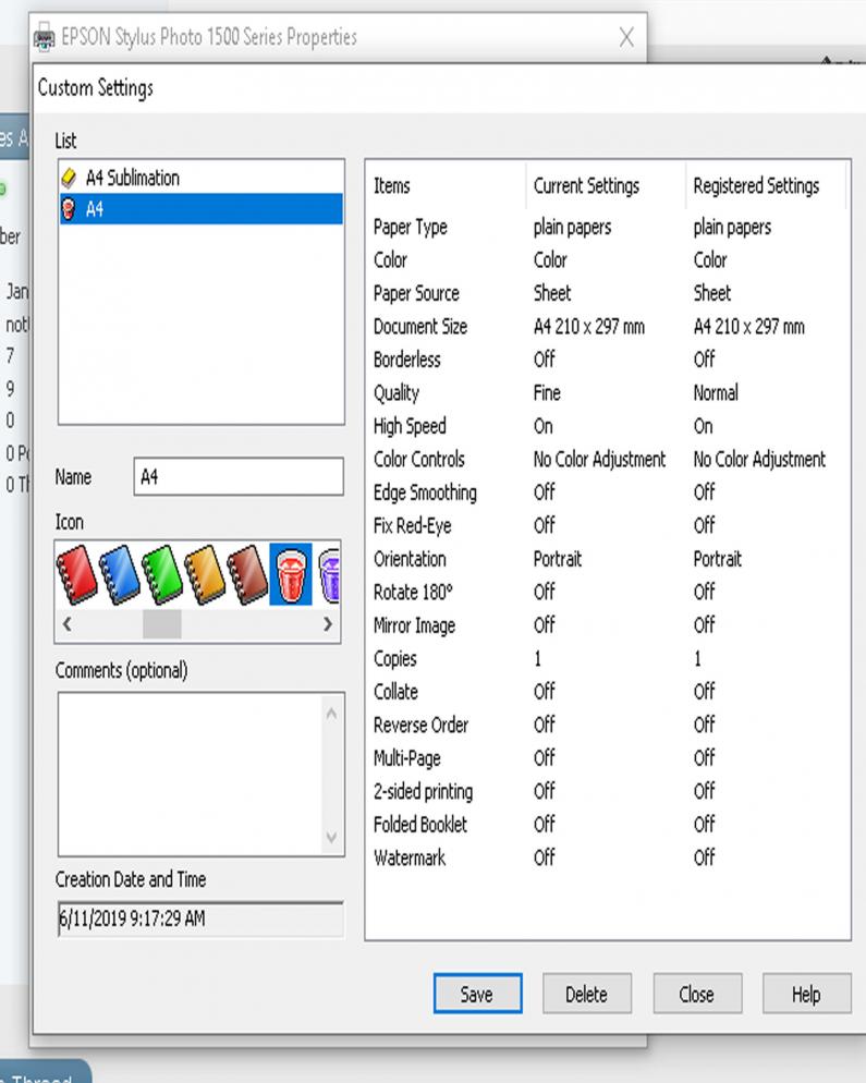

one thing i do seem to be struggling with is the icc for the epson as the info that came with the profile seems to be for a newer version of epson software so some of the things im supposed to select or switch off i can't find,
Are these the correct settings in the printer

pw66
Posts: 1314
Joined: 05 Nov 2015, 22:59
Re: Couple of problems desperate for help
Post by pw66 »
vB_ID:5770
vB_ID:5770
Screenshot (7).jpg (19.14 KiB) Viewed 419 times
malcassy
Posts: 10
Joined: 29 Jan 2019, 23:21
Post by malcassy »
Thanks for the info i have managed to get the epson printing now, not sure if it's as good as the ricoh but at least its doing something :)
