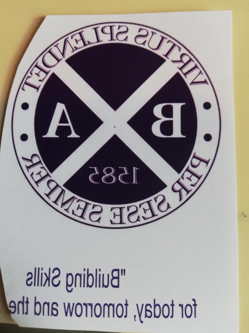

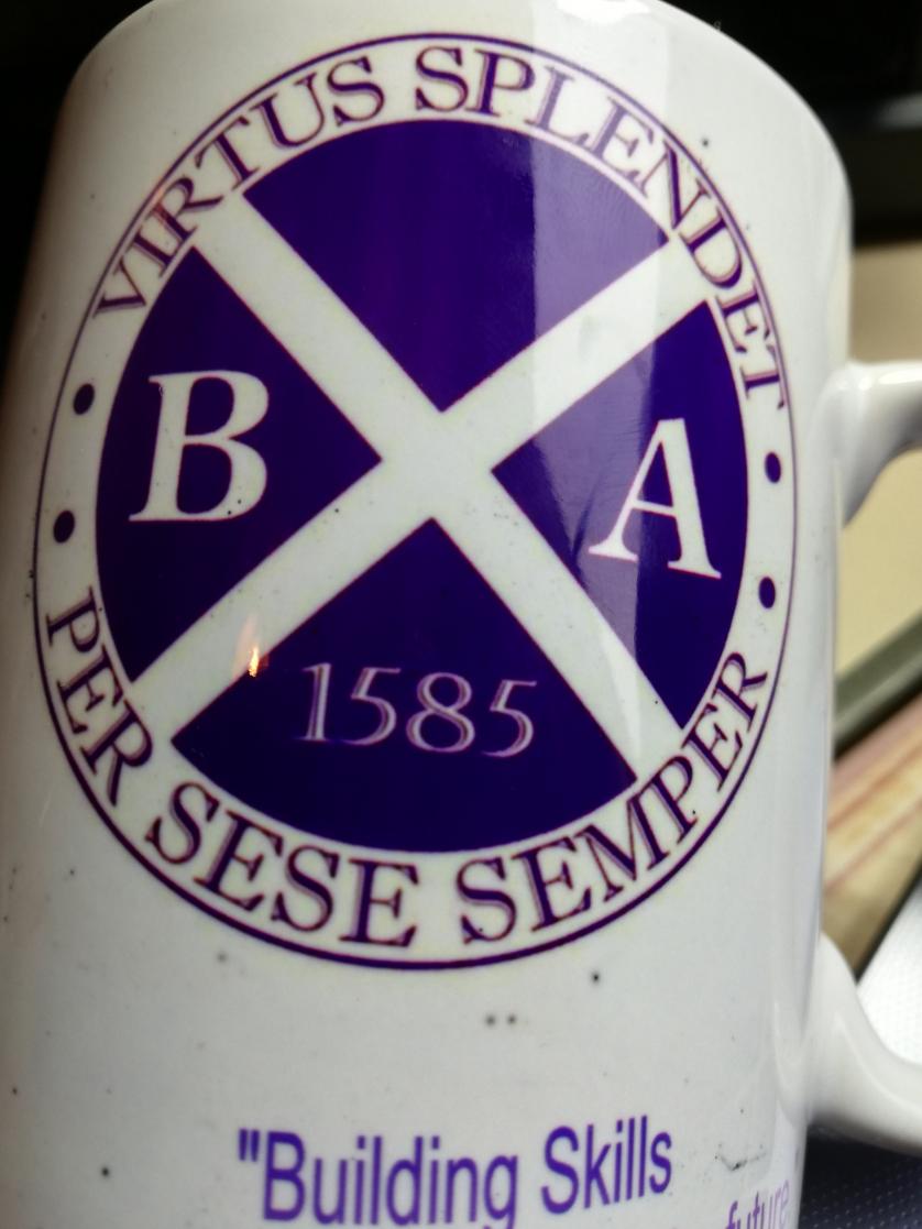

MY PROBLEM.
I set my mug press to 400o Fahrenheit.I then place my cold mug with printed sub paper taped on into the press and close the handle. The temp then drops down to around 340o f -350o f. This can take a while to come back up 400o f and then i start my countdown timer for 60 seconds.
When the mug comes out the transfer paper can be anything from light fawn to to dark fawn in colour. I take off the paper immediately and sometimes i am am getting fawn on the image of the mug and more annoying tiny specks of ink which aren`t visible on the image before taping on.
Can i have any advice from you guy re, should i warm the mug first?, is my temp too high, do i start the timer once the press comes back up to temp. Just any suggestions at all really.

What paper and mugs are you using?

Your unwanted specks could be caused either by trapped dust from previous prints or, most likely, by stray pixels in your image, or ink spatter from your printer. Try looking at your printed wrap with a good magnifier (I use 40x magnification). Even the tiniest, virtually invisible speck will come out larger when printed on the mug.
To test for stray pixels in Photoshop I usually make all the outside area of the image transparent then select the layer. The selection box should be almost touching the extremities of your image. If it isn't, then you have stray pixels outside of the image making the selection bigger and they must be erased.
