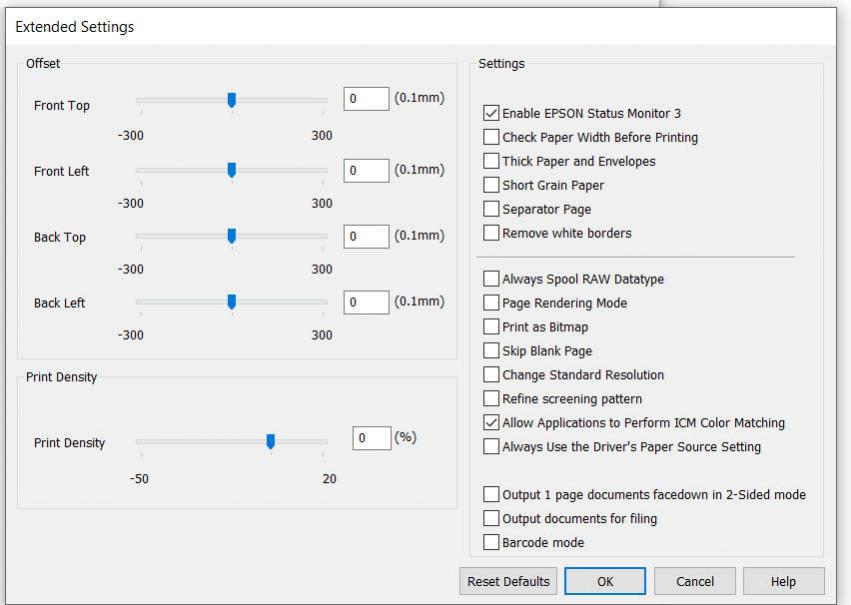

Just been through the same problem. Not sure if this is of any help but I found (after many frsutrated hours) that just reducing the print density on Maintanence tab, extended settings, by 10%, the ink still lays down enough but also dries before hitting the rollers.
I only need to do this on the HR paper.
Richard

Thankf ro that Richard. I'm looking at the same setting on a different Epson printer to cure the issue. I can see where to change the density but as you need to select "no colour adjustment" in settings for Sublimation will this still work?
Re: Possible Pizza cutter printer issue fix - Epson WF2010 + WF7710
I think the print density on the "Extended Settings" is a global override and still works with "no colour adjustment". The print density in extended settings looks to be driver related. The Epson XP-900 driver doesn't have it but the Epson WF-7210 driver does.
[ATTACH=CONFIG]6030[/ATTACH]
- vB_ID:6030
- settings.jpg (51.73 KiB) Viewed 313 times
