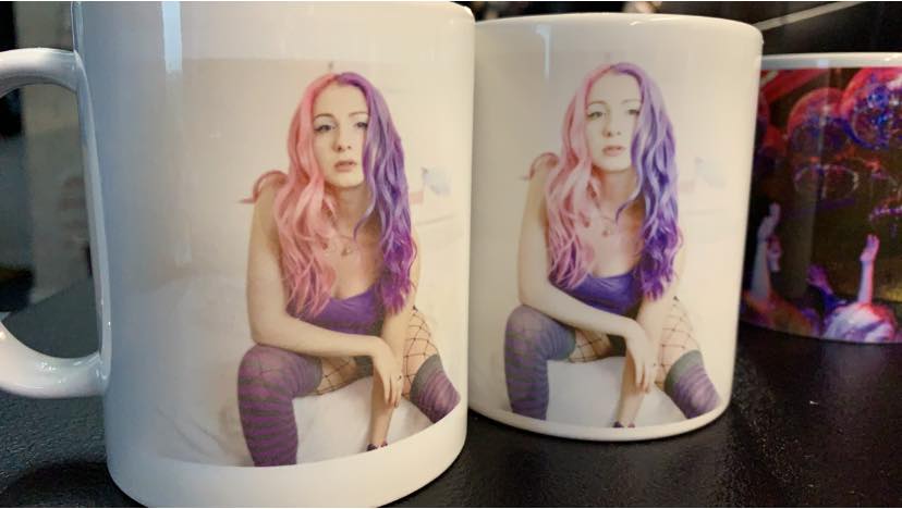

I recently switched from a Epson XP-342 system and purchased a Sawgrass SG400.
My chain is now Mac -> SG400/SublijetHD inks -> Trupix Paper -> Dino coated mugs -> Galaxy Pro press. Press and mugs came from Subliblanks, printer/ink/paper came from MDP Supplies.
I'm struggling with the SG400 as far as colours are concerned. Images seem to be printing off much brighter and less vivid/more faint than they appear on screen, and this is translating on the mugs I'm sublimating - I understand there is obviously going to be some discrepancy between what is on screen and what is printed/sublimated, that's just how colours work, but the difference here is notable (please see attached image). Very very expensive printer for such low quality prints.
[ATTACH=CONFIG]5922[/ATTACH]
The left mug printed using the Epson, and the right printed using the SG400.
Have tried all the colour settings within Virtuoso Print Manager, and I've also tried going direct through Photoshop and bypassing VPM with an ICC and it's making no tangible difference. Done nozzle checks/cleaning etc. No avail.
Can anyone please help? I'm using Trupix paper and the Sublijet-HD inks that came with the printer.

Have you changed the times and temps on your press? They will also make a difference as you are now using different inks.
mikeylord
Posts: 2
Joined: 05 Oct 2019, 16:20
Re: Sawgrass SG400 Printing Faint Colours
Post by mikeylord »
Hey, yes I have. I've muddled around with time, temperature and pressure settings - thought that was the initial problem to be honest. I've tried printing the same design on the same paper with the same print settings on my Epson and done a side by side with the Sawgrass, and the Epson is SO much better. Beginning to think it's just the printer...
