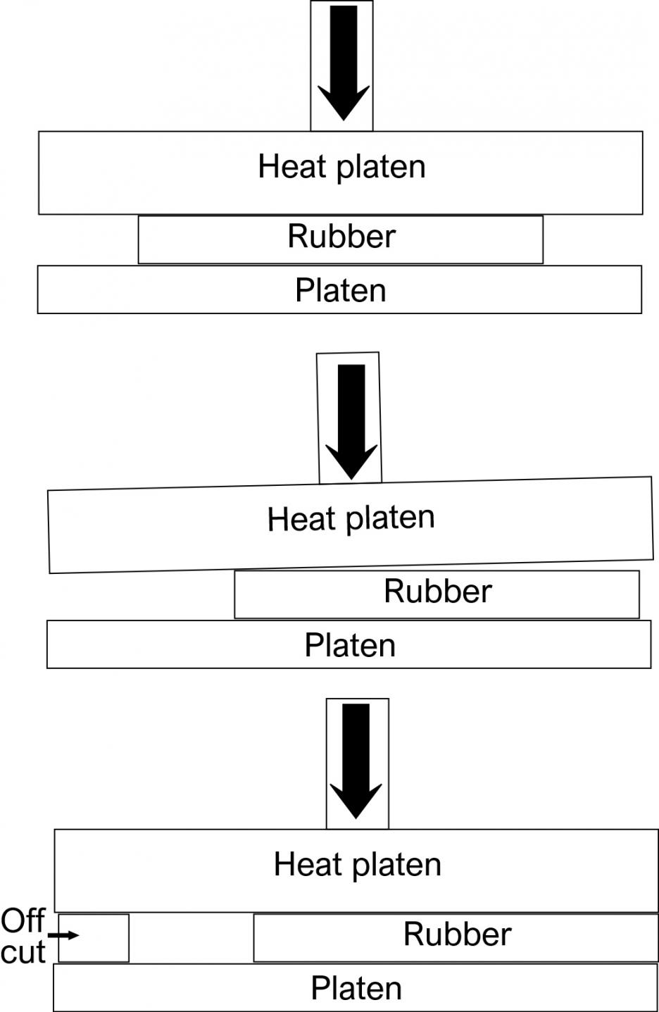

Could be uneven pressure leading to an uneven print.
If you are using an extra piece of platen rubber it needs to be dead centre under the presure adjustment - if not the heat platen will pivot, reducing pressure at one end.
Either move your rubber to the centre or balance the platen with a small off cut of rubber.

Thanks for that info. I am using just one piece of rubber at the minute and it is the same size as the platen so it is presumably centered ha.
If I ever get it figured out I will remember this when adding another bit of rubber for the smaller items I press.
