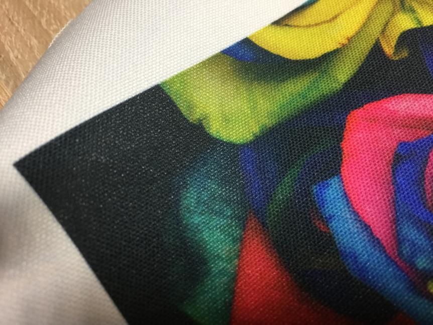

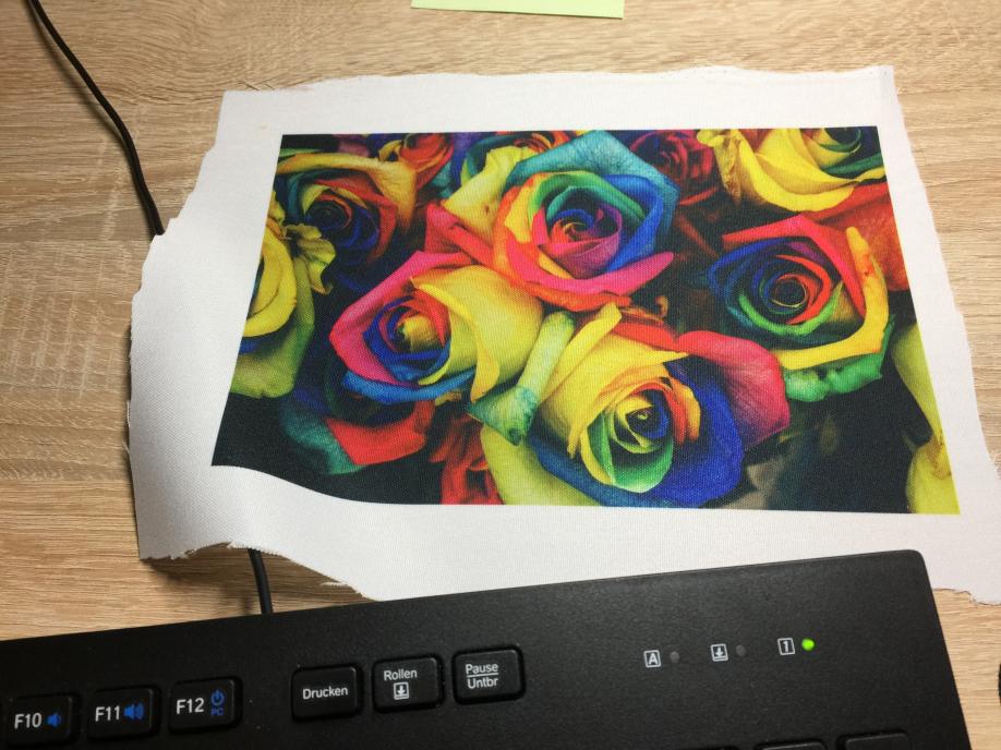

Thank you, i did that and today was the first time i sublimated something on a piece of polyester i bought from amazon for 2 Euro per square meter. The first try with the Versa paper went a bit dull, i did 195C for about 45 Seconds. 2nd try i increased the pressure and the time to 60 secs and it looked better but this time it was the S-Race paper. So i am not sure if this was because of the increased pressure and time or because of the S-Race paper instead of the versa. I could see on the Versa paper that alot of ink left on the paper while on my 2nd press the ink released pretty good from the paper.UK Printed Mugs;141682 wrote:Talk with Alex or Christian from inkexperts.co.uk
I am not an expert, the image sublimated to the fabric looks not as sharp i have to say but maybe thats normal because of the structure of the fabric. I also printed the same picture on my normal Canon inkjet printer and i have to say that the colors of the sublimated fabric are actually closer to the original

This is the sublimated piece of fabric(with ICC), maybe somebody can tell what i have to adjust
[ATTACH=CONFIG]6040[/ATTACH][ATTACH=CONFIG]6041[/ATTACH]

When sublimating to fabrics you will loose detail due to the weave and texture of the fabric this is inevitable really and will vary from fabric to fabric. Fien weave like silk polyester will be very good for detail, whereas open weave like linen or canvas will be less detailed due to the structure of the fabric.Daninho;141908 wrote:Thank you, i did that and today was the first time i sublimated something on a piece of polyester i bought from amazon for 2 Euro per square meter. The first try with the Versa paper went a bit dull, i did 195C for about 45 Seconds. 2nd try i increased the pressure and the time to 60 secs and it looked better but this time it was the S-Race paper. So i am not sure if this was because of the increased pressure and time or because of the S-Race paper instead of the versa. I could see on the Versa paper that alot of ink left on the paper while on my 2nd press the ink released pretty good from the paper.
I am not an expert, the image sublimated to the fabric looks not as sharp i have to say but maybe thats normal because of the structure of the fabric. I also printed the same picture on my normal Canon inkjet printer and i have to say that the colors of the sublimated fabric are actually closer to the originalI guess thats because i use aftermarket ink on my "normal" desktop Inkjet, it always printed blue instead of turquoise.
Our Subli-Versa paper is great for all substrates, but you will get improvements when using Subli-Fabric HR our high release fabric specific paper. Also we find using a Teflon sheet will further improve transfer as it helps with heat dispersion and seals the print better during transfer so minimises the escape of the gas whilst the ink sublimates to the fabric.
Alex
Re: which sublimation printer to buy for non commercial use?
Thank you for that advice, i bought cheap paper for that purpose because in youtube videos people said dont use teflon sheets. I already have teflon sheets for HTV.InkExperts;141953 wrote:When sublimating to fabrics you will loose detail due to the weave and texture of the fabric this is inevitable really and will vary from fabric to fabric. Fien weave like silk polyester will be very good for detail, whereas open weave like linen or canvas will be less detailed due to the structure of the fabric.
