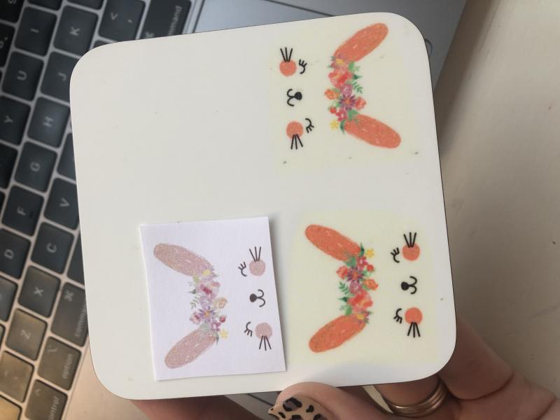

Hey Rich, I'm having this issue now with my Mac (Catalina) and PSelements 2020, sublimation is producing a yellow dotted image behind my .png in the shape of the paper - I thought overspray? Any advice?RichG;139821 wrote:Back in the game!!

Hi BeautifulSimplicity, the only way i can think is to delete the image background and see if this helps. You could also zoom in on all of the other layers individually just to double check the dots aren't included on those. One thing I noticed yesterday whist I was using my Forever Rip software.... I didn't have the license dongle in the pc so it automatically put dots on the image background as a kind of copyright thing. Maybe check in Elements that no copyright button has accidentally been pressed, in fact theres a copyright function on the printing section of Photoshop that might be worth checking. Hope this helps

[ATTACH=CONFIG]6062[/ATTACH]Hey, thanks for the reply
it’s definitely not anything on the image, it’s a png and happens with either a transparent or white background. I’ve also used a brand new file (transparent or white) and added text in any colour and it happens behind the text. I’ve had a brief look into the copyright function (it’s not something I’ve seen before with elements) but I’ll research it a little more.
I’ve added a photo from a coaster so you can see what I’m referring too. The coaster is overcooked (I know) but it’s hard to get the yellow on a photograph of the mugs, this is the best example. The yellow is made of tiny pin prick dots. On the mugs it is lighter but still visible to the eye.
I have gone from blaming my printer to the ink to the paper to the mug press - going round in circles.
I’m actually returning my printer this morning and getting a replacement to see if that will help at all, I have pressed “blank/none printed on” sections of sub paper on to a mug for 180/180 and it transfers nothing, so I don’t believe it’s down to me “over cooking” with the press or the paper (tried ASub and Truepix) which leaves me with the printer or the ink
I only bought my set up in December - Epson 2710, St210 press so it’s becoming wholly disheartening that it’s not going to plan

Yep looks exactly what mine was doing. Have you tried doing a fresh install of the printer driver? Probably best to completely remove the printer and driver from your Mac and install again. You could also try and print through another program to see if you get the same result? Do you use an ICC? If so maybe remove and reinstall. If I remember I also tried printing a pure white image. If it's pure white the printer should pull the paper through without printing anything

I haven’t no, I’m off to fetch this new one this morning anyway so I’ll remove everything (inc my iccs) and then try again from scratch. The epson was a nightmare to install so I was avoiding having to remove it unless it was a last resort.
I was given four standard iccs to try and have everything to print to arrange a custom icc but I can’t do that if I’m having this yellowing issue. When I initially set this up pre Christmas I printed 5/6 mugs and they’re were fine, came back to it after Christmas and then the problems started and seem to be worse, I’ve done several nozzle checks and head cleans (thinking maybe a blockage?) but everything is fine. I can only think that some kind of update occurred that may have upset things??

Before I take it back ive just reinstalled the printer and put the inks back in. I've printed my small image (text in this case) and opened the printer while it prints, after its printed my small it text it seems to continue to print the rest of what would be the background of the page. In this instance I even added an additional 255/255/255 white layer so it shouldn't be printing this surely?? - completely baffledRichG;142060 wrote: I also tried printing a pure white image. If it's pure white the printer should pull the paper through without printing anything

Get hold of a high power magnifier (I use a cheap 40x magnification jeweller's loupe from ebay) and have a VERY close look at the white areas of your printout, specifically looking for yellow dots or dither patterns. If it's absolutely white then your printer, image and Elements are working correctly, so then you'd have to suspect the paper (couldn't be your press if it's happening on both mugs and coasters).
Are you printing using RGB or CMYK settings in Elements? You should always be using RGB.
