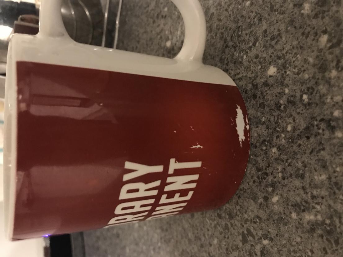

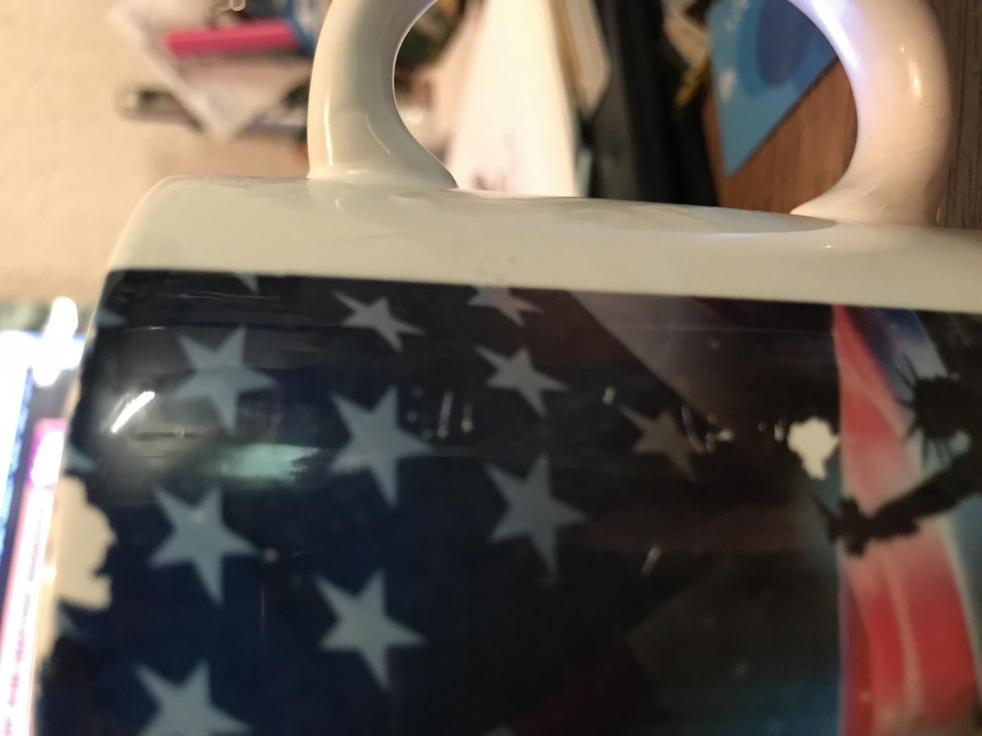

I bought a mug press and mugs and started doing a few mugs for friends and family and word of mouth sales. But the print on the mugs are coming off in places as shown in the photos.
I know this could be a whole host of causes especially as I've bought the cheapest of anything to begin with. I'll start with the press, its a pixmax one which came with a lot of mugs. I noticed this problem and so tried another lot of mugs this time from ebay this time from signzworld the 11oz orca double coated ones. I have the same problem with these.
I'm guessing the problem lies with the printer or the ink. I'm using an epsom wf-2750 with srace paper. The inks I'm using are bought off ebay and are probably cheap chinese rubbish. I've attached a photo of the inks.
The mugs look great when first printed but after a few washes the print comes off in random places. I'm thinking off just starting afresh with a new printer and new inks but would like to keep the costs down while I'm just starting off so I would welcome any help from you experienced guys with 1, your thoughts on the causes of the problems and 2, recommendations for a new printer and inks that are tried an tested.
Also any thoughts on the mugs I'm using would be welcomed. sorry for the photos being sideways I couldn't see how to rotate them. Thanks in advance

There's absolutely no way sublimation ink should produce results like that. I'd certainly ditch the inks you are using, flush out yor printer and use inks from a reputable supplier such as [MENTION=9497]InkExperts[/MENTION], who advertise in this forum.

Wow, I'd be inclined to point the finger at the mug to start with. The photo looks like the coating has chipped away taking the ink with it. Poor quality coating by the looks of it. Although you say you had Signzworld mugs, I have never had an issue with their mugs, they aren't the best out there but they are certainly not rubbish so its an odd one.
Like you said, your issues are complex because you've purchased lots of cheap products from different sellers so its hard to track down the route of the problem.
If the print is good to begin with then the ink / paper / printer etc are arguably ok. The issue occurs after washing, so I would naturally look to the coating of the mug being the issue as a starting point.
Weird one though, never seen that before. Perhaps a faulty batch of coating on a batch of mugs?

I am guessing they are hand wash and not dishwasher? That is a mug coating issue. Seen it before and generally happens due to the coating being a bit soft when heated during washing and another hard item scrapes against it. Try out some mug options as a starting point. Wouldn't just scrap everything. If they are actually AA Orca that shouldn't happen so I would have my doubts on actual coating standard ( I have previously queried whether it is an actual Orca coating and had my doubts).

thanks for the reply. I know it looks like the mug is chipped but it isn't. It's the ink that has come away. Its happened on the mugs I got with the press from pixmax as well so I'm thinking two lots of different mugs with the same problem would point to the problem being somewhere else. I think I'll just buy a new printer and inks from ink experts and see how that comes out. Any suggestion on printer and inks? thank you

Ahh very strange, it does look like a chip or scrape in the photo. Perhaps the ink is poor quality and isn't bonding with the polymer coating on the mugs? If you are in the market for a new printer we have a number of sublimation converted packages on our website. The WF2630 is very similar to the WF2750 you currently use. We are starting to push more Ecotank printers as they are easier to use / convert to sublimation, so if budget allows consider the ET2711 or ET2650 as well. All work well producing excellent quality results and offer excellent value for money.gavham;142144 wrote:thanks for the reply. I know it looks like the mug is chipped but it isn't. It's the ink that has come away. Its happened on the mugs I got with the press from pixmax as well so I'm thinking two lots of different mugs with the same problem would point to the problem being somewhere else. I think I'll just buy a new printer and inks from ink experts and see how that comes out. Any suggestion on printer and inks? thank you

More than likely still scrapes with mug against mug type of scenario but done at source. During coating they were probably moved to early and not having hardened sufficiently. Not a common thing these days. Would imagine/hope SW just had bad luck with a few boxes. Contact them to let them know as it will always help a supplier if there are possible issue's.
