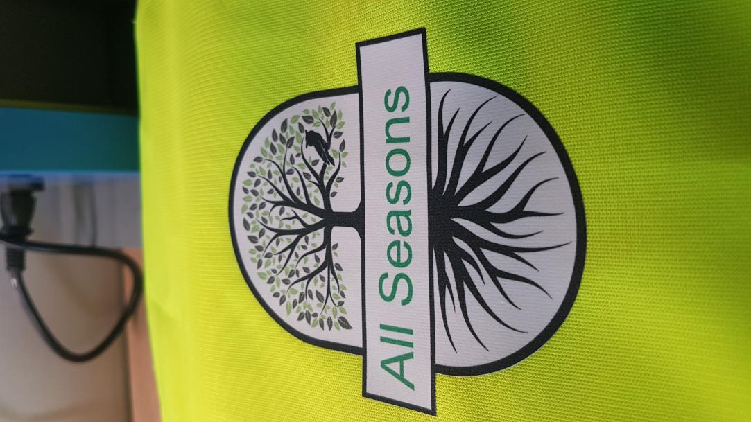

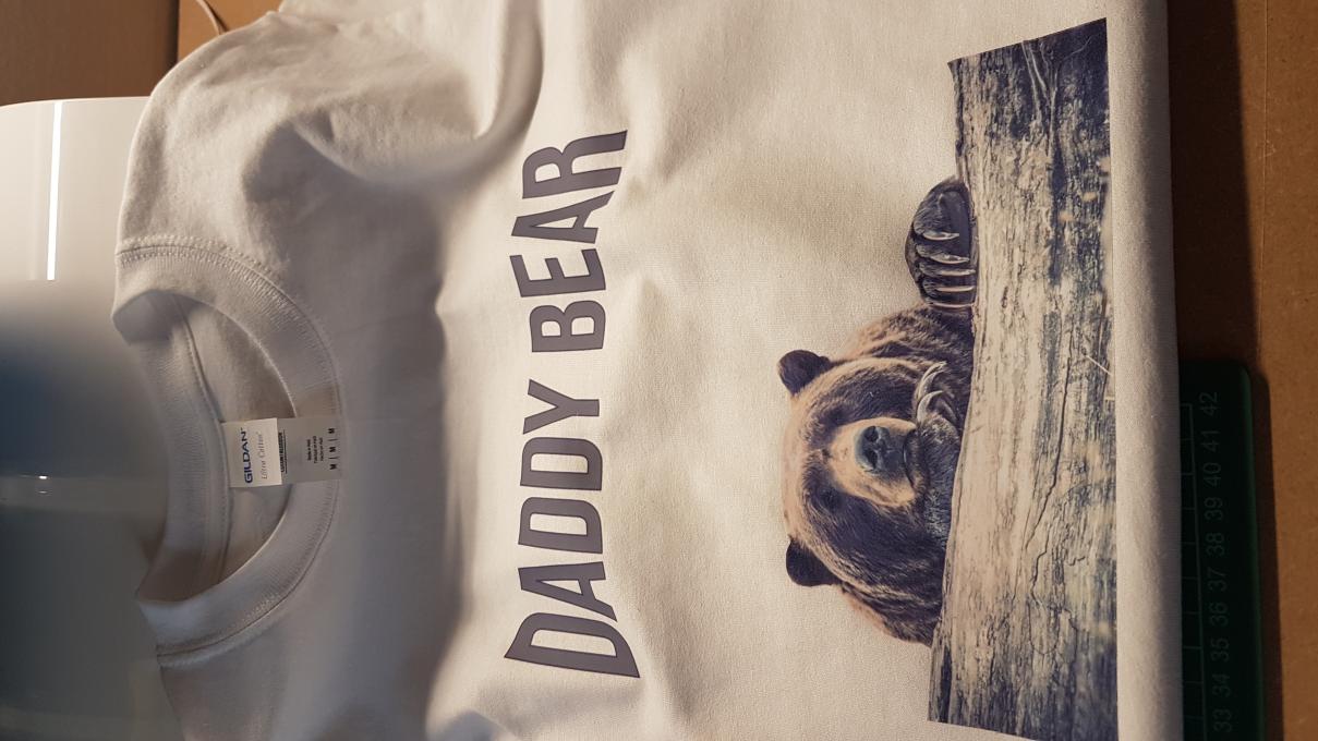

You can use siser easi subli for cotton, I have mastered it now and you can adhere it to 100% cotton 155 degrees for 15 seconds.[ATTACH=CONFIG]6196[/ATTACH]

billy8581;143175 wrote:You can use siser easi subli for cotton, I have mastered it now and you can adhere it to 100% cotton 155 degrees for 15 seconds.[ATTACH=CONFIG]6196[/ATTACH]
That's a solution, but I'd imagine it has a 'hand' to it, like HTV, and also, of course, you need a vinyl cutter, so a more expensive initial setup and extra time spent weeding.
Have you wash-tested that stuff billy? I'd be interested to know how long the print lasts, and whether any brand of sublimation inks can be used.

Hi Web. The hand is very impressive. Like a thin htv sports vinyl. Nothing like the solvent printed logos you get on the thick backing. The wash-ability is very impressive too, I cannot see a difference in the before and after, having washed some designs 5 or 6 times. I always wash them inside out, and it is recommended that you don't go above 60 degrees. I like them for printing high vis vest logos[ATTACH=CONFIG]6197[/ATTACH]
Im using Sublijet HD inks and they are very good. They recommend you use easi subli, but I can tell it really doesn't matter.
