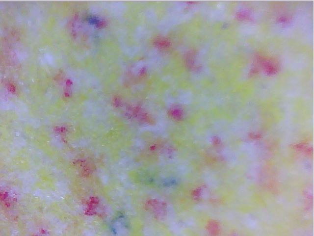

I got a WF7210 since a few days, i converted in to sublimation with a CISS container
When printing Yellow i noticed a strange thing in the color, (i don't know for sure if it's only the yellow that is having the issue)
photoshop (in cmyk) gives me 100% for Y
[ATTACH=CONFIG]6194[/ATTACH]
but when printing in notice the color seems to be "off", when using a microscope i see these colors, any idea why magenta & cyan are being printed as well?
[ATTACH=CONFIG]6195[/ATTACH]
Thanks for your help

Re: Epson WF7210 - color issue
Hi,
When using sublimation ink and printing from Photoshop, the colour is normally set to RGB (not CYMK).
See if this solves your problem.
Skye
Skye
Skye
thanks for the advice, RGB / CMYK isn't the solution in my quest
I tested a print mug with ICC enabled and overlayed it with a non-ICC ; it seems the ICC is alterign the picture in that way. But in a way that i don't like it; so i think i'll just disable ICC in printing in this case
thanks for your advice
