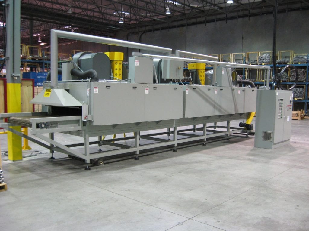

Our was similar to this
[ATTACH=CONFIG]6486[/ATTACH]
100s per hour.
