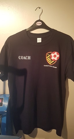

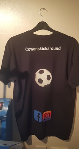

[ATTACH=CONFIG]6289[/ATTACH]I actually find it amazing to work with now. The ink has to be completely dry or the adhesion is terrible, also I rip the backing away really fast (odd but it works) I do use an sg800 with sublijet hd inks and I select the htv transfer vinyl setting. I have used it for several customers now and its great. high vis garment dyde will bleed into your design eventually, I need to experiment with lower temperatures to see if this always happens! Its work noting that for large logos you can simply peel the logo off the backing without the need for a transfer sheet. Also if you buy a roll it works out at around 90p per a4 sheet which is awesome. I use this material for tshirts and bags and Im hugely impressed.[ATTACH=CONFIG]6288[/ATTACH]
