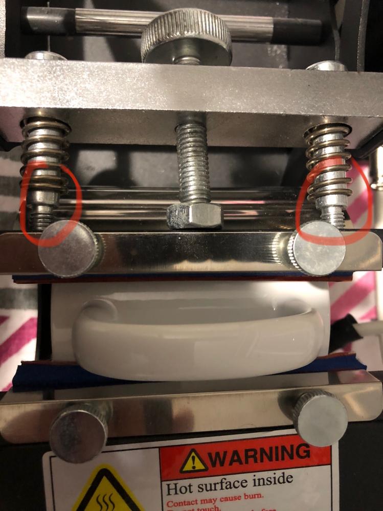

Just a quick question, I have a similar press to yours, mines a FREESUB version from eBay due to being out of stock at MPD.
I have attached a photo of the pressure screws, does yours look the same as mine? It has to be like this to get a firm fit onto a 11oz mug.
Tony
[ATTACH=CONFIG]6698[/ATTACH]

Tony4415;148385 wrote:Hi Mrteajunkie
Great info here.
Tony[ATTACH=CONFIG]6698[/ATTACH]
The two side bolts with springs in should be tight and never adjusted they are spring loaded to apply pressure.
the centre bolt (pressure screw) should be used to apply a little extra pressure.
With the centre pressure screw not touching the press close it with your mug in, and then tighten until you can feel the resistance.
then open the press and tighten the screw a little more then close the press making sure you don’t apply too much pressure or too little by adjusting the screw accordingly.
the nut on the pressure screw Is to stop the screw moving but I never use it.
Hope that helps?

Hi
I have tighten the x2 small screws and when I clamp the main handle down, the pressure is not firm onto the 11oz mug

[ATTACH=CONFIG]6699[/ATTACH]as you can see the x2 small spring screws are tight but the mug in the press is not firm onto the mug
