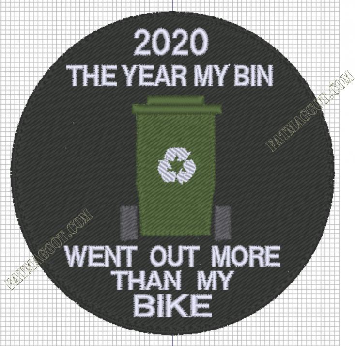

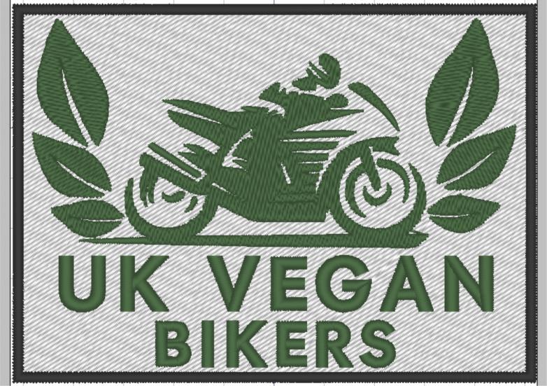

What came with the Ricoma ? I work in PE Design, lots of really helpful tutorials. Main thing with caps is the way it is set to embroider, from centre out, not across if that makes sense. It takes a while to get it right, but here are a few I have done myself.

HI Mrs Maggot ,mrs maggot;150347 wrote:What came with the Ricoma ? I work in PE Design, lots of really helpful tutorials. Main thing with caps is the way it is set to embroider, from centre out, not across if that makes sense. It takes a while to get it right, but here are a few I have done myself.
[ATTACH=CONFIG]6846[/ATTACH]
[ATTACH=CONFIG]6845[/ATTACH]
Nice designs they are ..Ricoma didn’t give me anything , Apparently just the UK Ricoma machines do not come with any software (Annoying and basic one cost £450 ) .
That’s why I am looking for a basic software I can do little things if needed .
