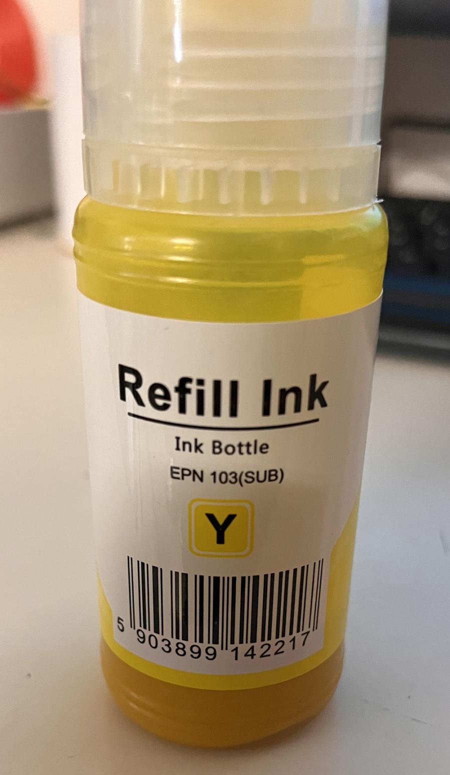

Hello, I'm writing about a certain issue that has been bothering me for the past week. At work, we use Epson L1250 printers with regular sublimation inks. We don't have access to an ICC color profile. In short, I would like to achieve a 1:1 effect. We work in CorelDRAW, and the templates are in RGB. The colors appear more reddish. We don't have much time to individually adjust the colors and saturation of each design to ensure satisfactory printing. Where can I find the golden mean? Is it in the color profiles, the paper we sublimate on, or could there be an issue with the printer? If I missed any details, please comment, and I'll clarify. Got some preview of the last projects in attachments.
