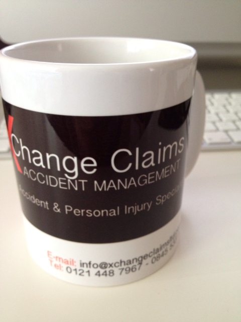

Hey guys, I managed to pre heat and followed your excellent advice...and it worked!
the white lines/streaks ! thank you
