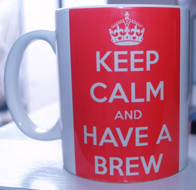

Here's a pic of my first mug, well my second actually. The first one didn't come out 100% as I think the mug was too low in the press. Just got the new gxe3300n today and had to have a go right away but it was a nightmare to set up. Powerdriver will not work, Coreldraw keeps saying there is a driver issue and suggests removing and reinstalling (which I tried), so I ended up just using the Sawgrass ICC profile for the GXe3300n, and it worked a treat.

Why won't PowerDriver work? All PowerDriver does is sits between the printer driver and the printer. Once installed you print to PowerDriver not the Ricoh printer. The main reason for it 'not working' is that the OEM printer hasn't been assigned to PowerDriver which is a setting within PowerDriver. Anyway, if you're printing with the ICC profile installed then that's fine.
Re: My First Mug & Powerdriver Issues
Colour right to the bottom, your mug press must be running nice & even. Looks great

No idea why it's not working. I downloaded the powerdriver for the epson r1800 and tried a test print on to transfer paper and that worked fine. I've since uninstalled that as I won't be using sub inks on it. Yet, doing the same thing for the Ricoh, using the same software just throws up a driver error. It will bug me for a bit as it makes no sense but the other mug I did had a union jack and the colours were spot on so I am happy with the setup as it is.

the first mug wasn't quite like that, so I lifted this one a few mm and it came out fine.sonywiz;45857 wrote:Colour right to the bottom, your mug press must be running nice & even. Looks great
