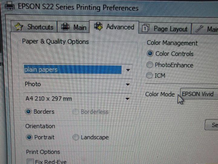

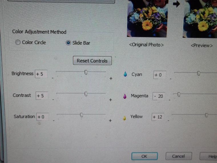

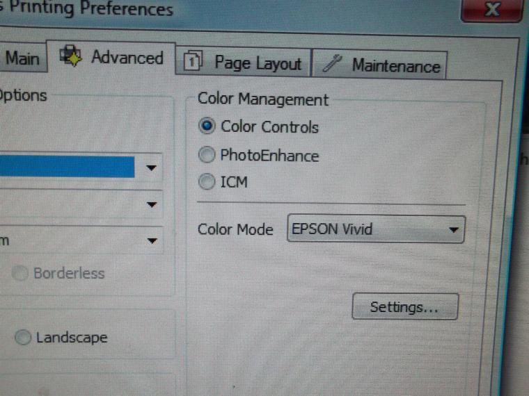

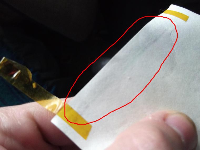

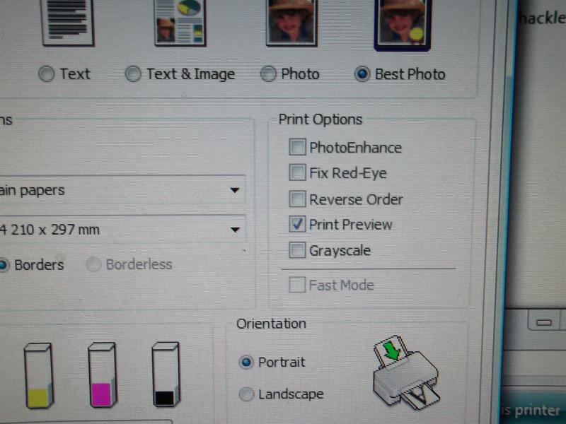

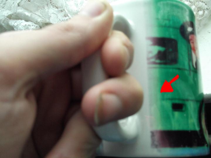

[ATTACH=CONFIG]1117[/ATTACH][ATTACH=CONFIG]1118[/ATTACH][ATTACH=CONFIG]1119[/ATTACH][ATTACH=CONFIG]1120[/ATTACH][ATTACH=CONFIG]1121[/ATTACH][ATTACH=CONFIG]1122[/ATTACH] sorry for taking a while to reply. it was saying my image size was too large. Ive included pics of my current Epson s22 printer settings, and a photo of the finished mug/grey line on the sublimation paper. Thank you.

OK. Immediate problems I can see.....You're trying to print too close to the handle hence the fade out. I tend to print 200mm x 90mm on a 10oz mug. Next problem. I'm now assuming you have no profile set up as your printer settings are wrong. Colour controls should all be off and ICM selected but only if you have profile installed.
With no profile you won't get a decent reproduction...with the wrong profile it won't be much better!
I can't really see the gray mark on the photo. What make of paper are you using and whose mugs?

Justin is right! you need to switch ICM off. then you will be able to print via ICC profile.

11oz mugs you'll obviously use a larger template, trial and error will get you as close as poss. to the handle but you're still too close here I'm afraid.
