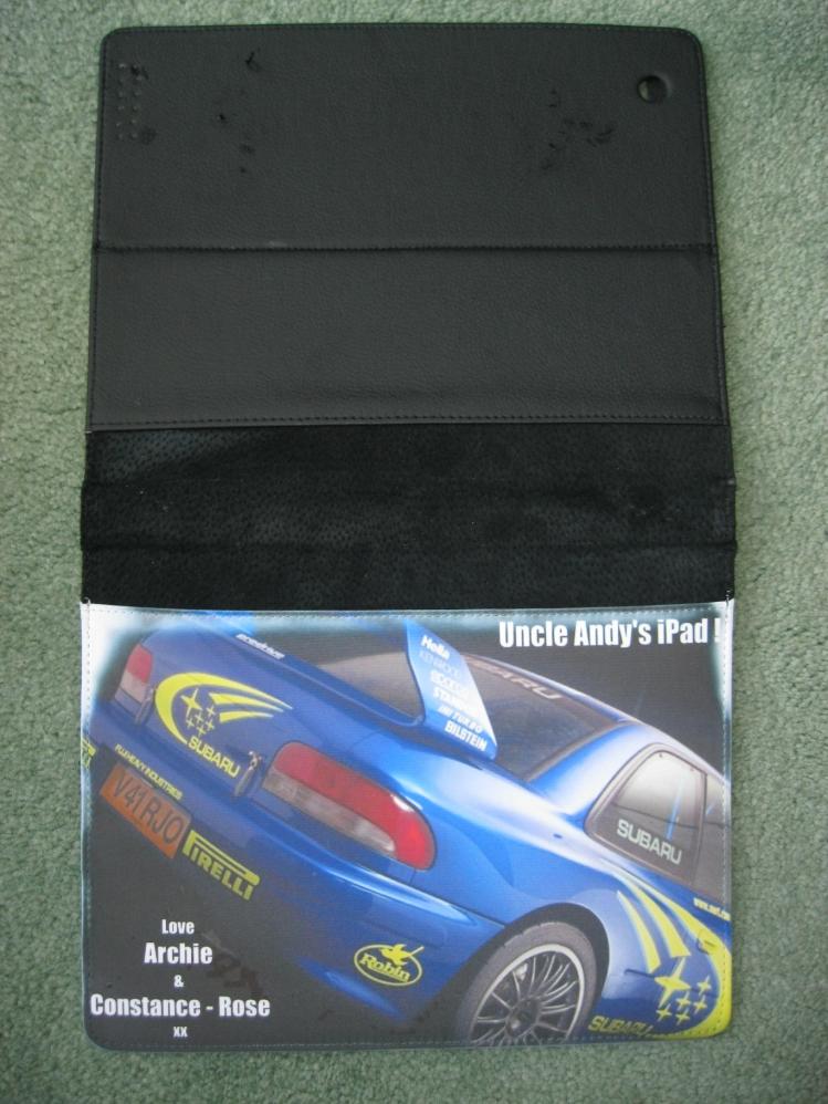

We have a new print item, iPad 2 leather case. We have had a few problems pressing it. The item around the top edges is not coming out properly, staying white only on the two corners.
I have used alot of pressure which has helped but no joy.
Any ideas what to do?
The iPad image is attached.
thanks

I dont remember time i used on one i did months ago. Bu i remember o had to use huge pressure as big as i was hardly able to close my press withour taking the handle off
worked great tho...

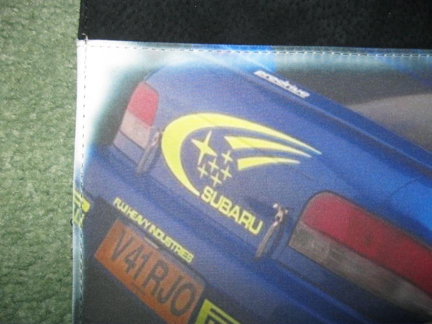

Re: ipad leather case issues
Our press temp is 180 c time is 55.
The press is Romark. The printer is a Ricoh 3300.
The attachment is the first print we tried. We increased the pressure next time to the maximum and it still came out with slight marks on the corner.
thanks
Lynsey
It looks to me as if its a pressure issue.
As Paul says you probably need to increase the pressure even more if possible. Some items it seems impossible to press, there are times where I have to use two hands and put my full weight behind the closing to get a good print. If you can not increase the pressure then you may need to put something under it.
Presumably you are pressing with the paper face down on top of the item, so its inbetween the heating element and the item. Some people put the paper face up, then the item and then the heating element which never works properly (IMHO) so thought I would ask
With the stitching make the edge thicker could you put some cardboard in side to even it up.
