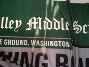

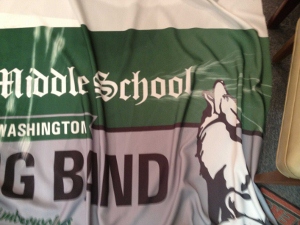

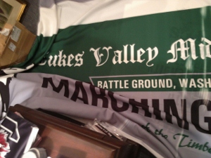

I currently have 10 Roland Printers -- Vary between 540's 740's and 1045s. The only time i have a problem is with larger prints -- we are transferring on a Kleverik 125 inch rotary press. I also have 5 rotary presses, but only run larger prints on the kleverik. I don't consider myself an expert but i've been doing this for 20+ years and have seen about every issue known to man in the sublimation realm, most we could fix, this one has eaten my lunch. It is becoming a consistent theme. My company makes products for the Collegiate and Pro Sports markets as well as high school, etc. I do very little printing of images on small format work. Instead we have to hit very specific pantones which causes us to probably use more ink than most anyone else who does this. I've adjusted every variable i know how and it's not fabric specific as it doesn't discriminate. Beaver has sent me 3 different papers, we've adjusted ink limits, profiles, time of day, letting prints sit and dry, transferring them immediately after printing, etc etc. I am starting to believe that its impossible to run anything over 50 inches, and it's all a hoax. Here is our most recent attempt. Ink limit is probably half of normal. I have 3 rolls of paper waiting to transfer and i'm terrified to attempt. Just a waste of fabric. They all follow the same pattern. First few feet is fine, then it completely goes sideways without rhyme or reason. Any one have any miracles?

CarFlagMaker;70843 wrote:I currently have 10 Roland Printers -- Vary between 540's 740's and 1045s. The only time i have a problem is with larger prints -- we are transferring on a Kleverik 125 inch rotary press. I also have 5 rotary presses, but only run larger prints on the kleverik. I don't consider myself an expert but i've been doing this for 20+ years and have seen about every issue known to man in the sublimation realm, most we could fix, this one has eaten my lunch. It is becoming a consistent theme. My company makes products for the Collegiate and Pro Sports markets as well as high school, etc. I do very little printing of images on small format work. Instead we have to hit very specific pantones which causes us to probably use more ink than most anyone else who does this. I've adjusted every variable i know how and it's not fabric specific as it doesn't discriminate. Beaver has sent me 3 different papers, we've adjusted ink limits, profiles, time of day, letting prints sit and dry, transferring them immediately after printing, etc etc. I am starting to believe that its impossible to run anything over 50 inches, and it's all a hoax. Here is our most recent attempt. Ink limit is probably half of normal. I have 3 rolls of paper waiting to transfer and i'm terrified to attempt. Just a waste of fabric. They all follow the same pattern. First few feet is fine, then it completely goes sideways without rhyme or reason. Any one have any miracles?

Sounds like you know what you are doing. We print direct-to-Fabric with our large format, I have never done paper transfer on large format. We print products for Collegiate and ProSports as well as HighSchools too, and need to match colors. I know we went through a lot of fabric and inks before finding the magic combination. There was a lot of frustration.

Thanks for the reply. I'm just aggravated. I know you can feel the pain. I have put off the direct to fabric for years but i guess that is the road that i'm headed. Just more aggravated that i actually bought the sales job of this paper transfer solution and i just don't think it works for large prints. What types of items do you make? Can exchange info and see if there is any opportunities to work together on something. Good luck to you.

To me that just looks like the material was not totally flat under the heat source. The larger the material the harder to keep it going through evenly on a rotary. I guess there are limitations on size and you have found it. Never used a rotary myself but recognise those markings from other products and it basically comes down to lack of direct contact.

Are you using a sticky transfer paper to help keep the fabric and paper together?

Andrew, thanks for replying. The material is pulled tight.
Pisquee, no i don't use sticky paper. I use Beaver 106" texprint xp. The conundrum is that everything else i run, no issues. Until we go over 50-60" in width and 7-8 Ft in Length. If i run 3 ft x 8 ft it runs perfect. But when i go larger, ie 5 or 8 ft x 7 or 12 -- it completely goes sideways. That is why i think deep down it doesn't work as it's sold.
