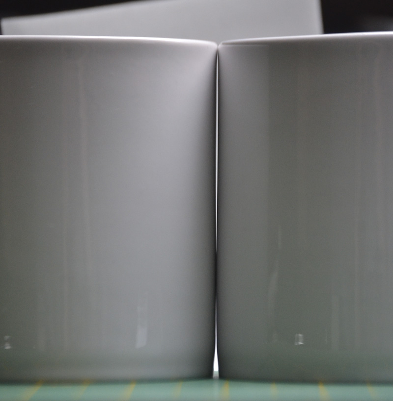

Re: Mug problems
Have you done a visual test?
By this I mean put two of the mugs next to each other and look at the gap inbetween. There will be a gap unless they are 100% straight (which not many are) but it will give you a good visual test of how bad the tapering is.
Also can you upload a photo of the mug or preferably the visual test.

Re: Mug problems
[ATTACH=CONFIG]1859[/ATTACH]
here's a pic of the tapering. i've also noticed that there is quite a variance in mug sizes withing the same box. the first 2 mugs i picked up to do this pic had a 2mm height difference - doesn't sound much until someone orders 2 of the same mug and you see them next to eachother.
