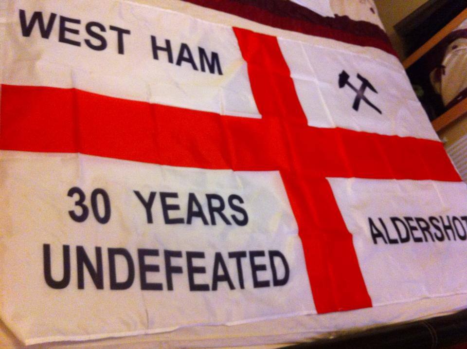

[ATTACH=CONFIG]1881[/ATTACH]
i've made banners before on a wide print format mimaki , but im seeing these , the flags are 5ft by 3ft its got a print in each corner and the flag red part is probley bought in like that, im thinking with a a3 printer it still wouldn't look that big , just trying to figure out how there making these

That red looks woven on so like you say probably bought in like that. The rest you could do with black vinyl and press it in sections I suppose. Not a massive job but probably a bit hard to maneuver on the press.
'Undefeated' looks kinda wonky!

Looks like a cheap bought in flag and the lettering applied in vinyl......cheap and practical for it's purpose but not a 'good' quality flag.guarddog14;74612 wrote:[ATTACH=CONFIG]1881[/ATTACH]

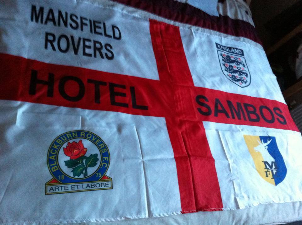

sorry i put a image of a really bad examle up , how about this one [ATTACH=CONFIG]1882[/ATTACH]

Now that looks printed, dye sub/digital maybe?
