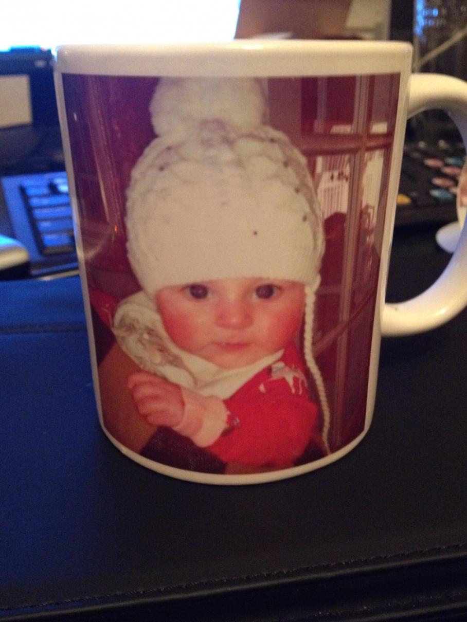

Answer is I don't know as I brought it but doesn't say any brand on cartridges. I have attached a image of mug I did. But not sure on quality

We cant really tell quality from your image, bad lighting and we have not seen the original image.
it does look familiar to me though, seems consistent with using chinese inks - this is the most common topic here I think, people trying to get away with using bad consumables.
it just never works and you are wasting your time.
you will always have problems until you bite the bullet and use proper ink.
I learned the hard way too.
