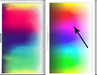

edit:
this is exactly what is happening with my printer.
where is this pinkish colour gone? is not on the pressed material. also what happened with red? turn in to pink. Honestly guys :) i expected bit more for this price.
but again... for images is great. but for spot colours it sucks!
[ATTACH=CONFIG]2939[/ATTACH]
vB_ID:2939
vB_ID:2939
Screen Shot 2014-08-24 at 13.12.09.jpg (19.71 KiB) Viewed 133 times
