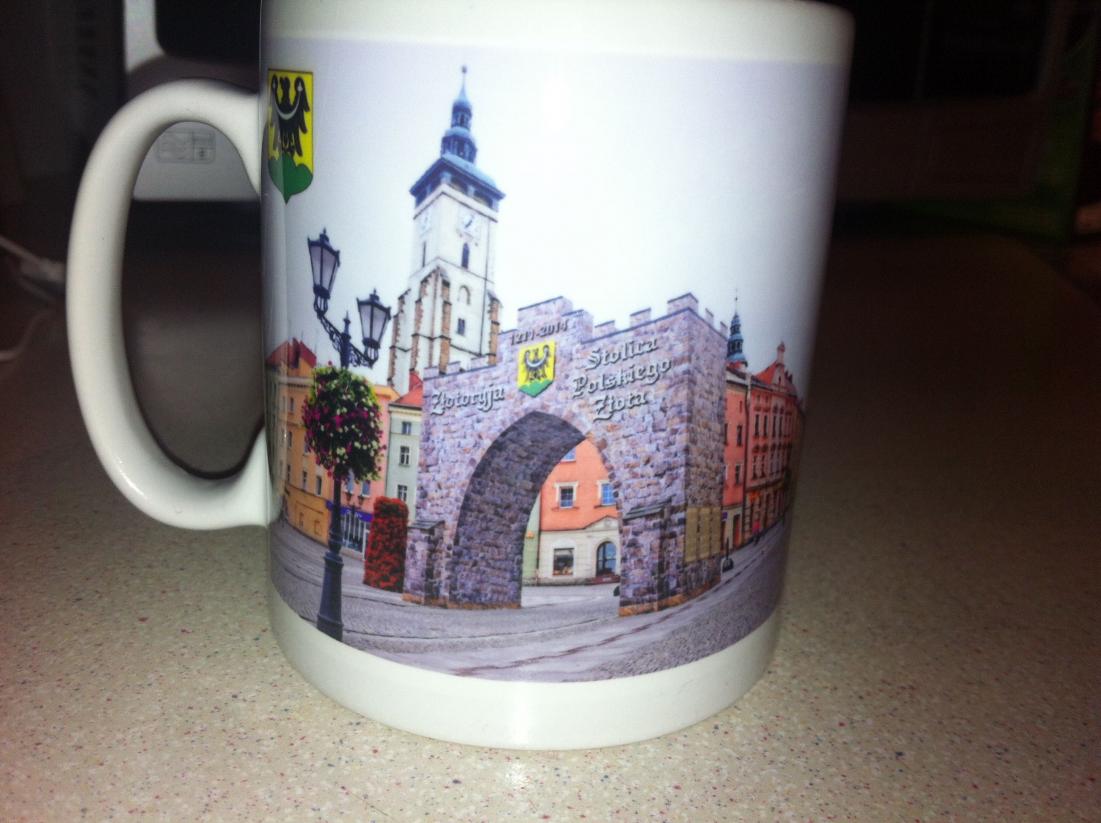

Re: New to 3D Mug Sublimation (Mini 3d sublimation machine)
here are the results.
http://www.dyesubforum.co.uk/vbforum/sh ... #post92303
i had it for 180C and 770sec. but people say this is to much :)
