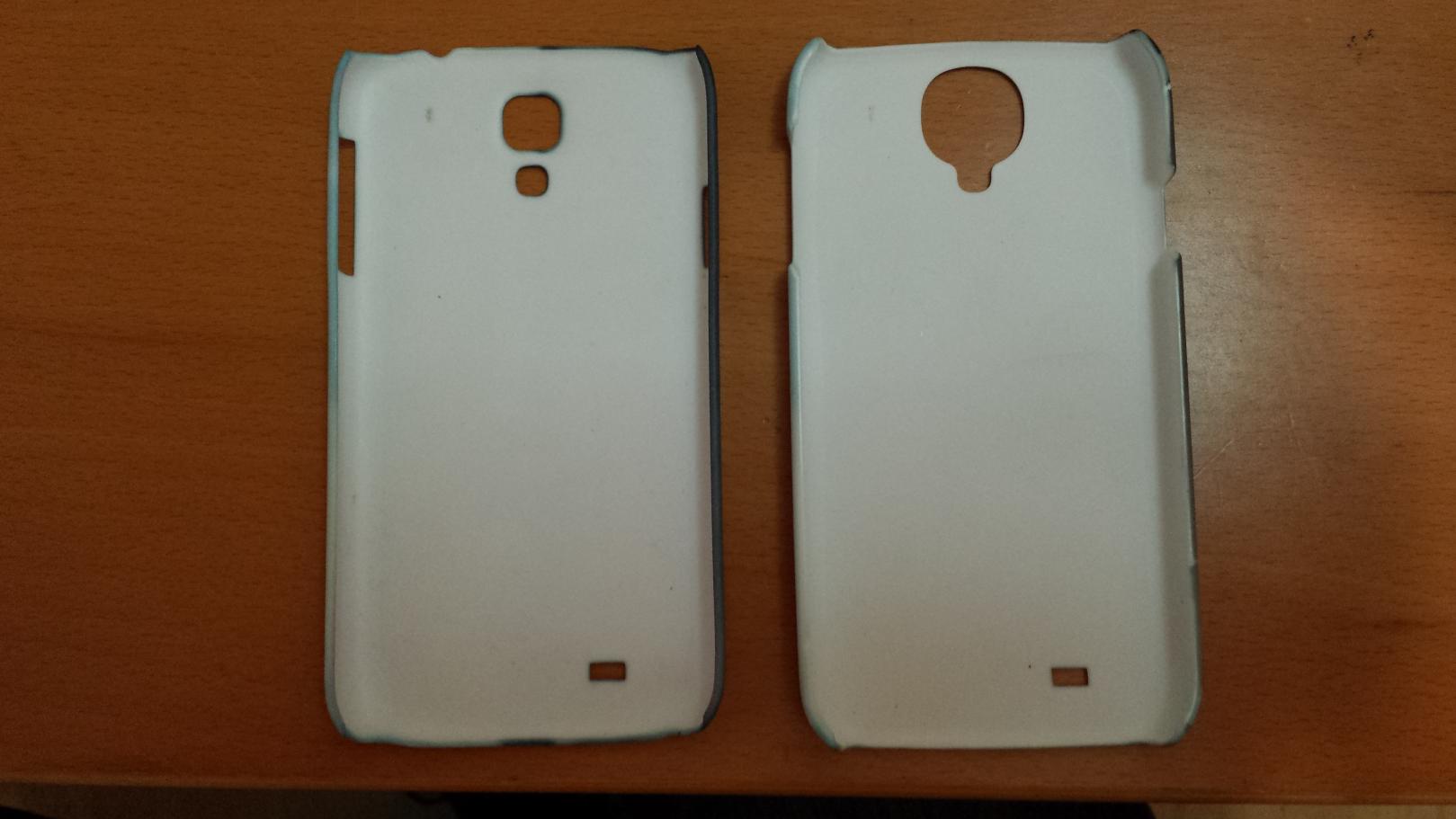

[ATTACH=CONFIG]3016[/ATTACH]
The one on the left is the newer one that I'm having problems with. The right hand one has been fine. Which also leads me to think it's the case but don't want to send them back until i know it's not me doing something wrong!

I use the one on the right hand side and yes, it's been really good with fit. No complain, not even once. The other design that I have is NOT the left hand side. But yea, it can be problem with the case.

This is interesting. I dont like the narrow bit that goes round the side buttons anyway. They go out of shape.

I've tried again today with a little more success by putting it straight into the water. The newer case fits, but not as well as the right hand ones. I think it's a bad designed case as I've done another one of the right hand one today too and that clicks on real nice.

Right... every S4 case I've made has been the one on the left! I don't particularly like them, if I'm honest, and use a Dremel to remove the thin bars around the buttons and smooth it down so it looks like they came from that from the factory. I tried buying the ones on the right from a company in China but they ended up sending me the ones on the left instead and wouldn't give me my money back.
This is what you have to do... as soon as you take it out the press, put it straight on to the dummy phone then pinch all four corners in very tightly while you slowly lower it into cold water, then hold it there for a good thirty seconds. That's how you get them to fit. It's a pain, but as I've not ever been able to get any other S4 designs I've had to compromise and live with it.
I'm REALLY interested to know where you get the cases on the right from. It takes me twenty minutes PER CASE to remove the bars and smooth everything down, so I generally do ten at a time but it takes me hours and I'd much rather spend my time elsewhere, so I'd appreciate knowing where to source these from.
