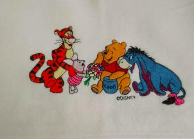

Paul;94365 wrote:i can see them all! amazing! how long took you doing Winnie the pooh and the hang?

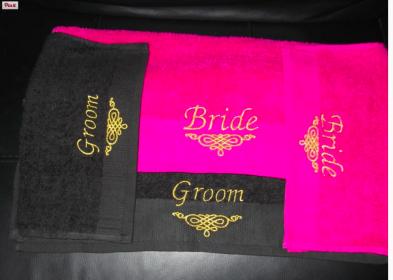

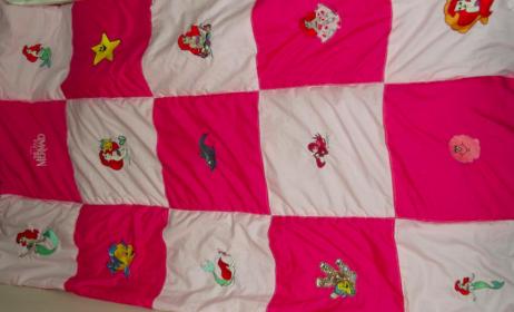

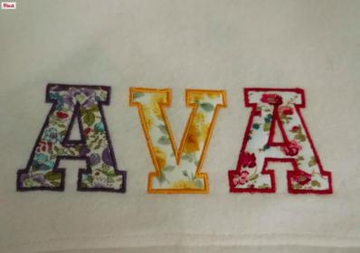

Thanks Paul... Much appreciated! Viccar, that's some great work there! Very impressive.

Paul the poo design i think took about half hour, but apart from changing the thread you can do other things while its embroidering, it will stop once its finished that colour.

Some nice designs there , can you embroider beanie hats with text / logo with one of these machines and shirts etc.? I know they are slower then the commercial machines but for one or two items it would be good to be able to do it.
