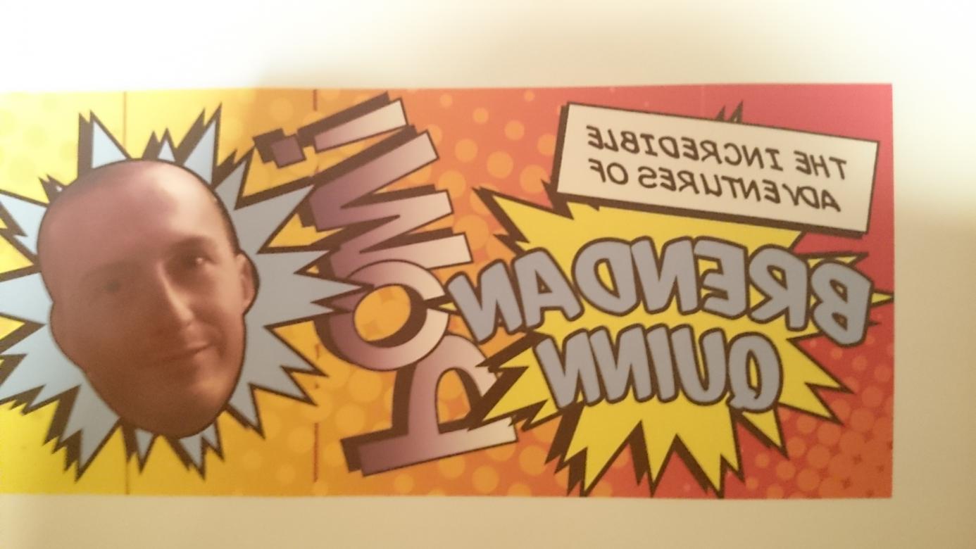

Hi,
I was hoping someone could help me? as you can see in the attached photo are red lines appearing on the template and I don't know how to resolve it.
Does anyone have any ideas?

Have you tried printing nozzle check pattern?

I have done the nozzle check and alignment and all is perfect there. not too sure why its happening.

Are there any red lines appearing on your nozzle check page? How has your printer been until now? Are youbusing powerdriver. Do a head clean and run the clean in nozzle check anyway my yellows were printing faint and nozzle check showed grey line and similar lines to yours.appearing in grey however not red.

Problem now resolved :-) I was using Photoshop elements then tried it on another version of Photoshop and it came out perfectly. Good Times lol
Not sure why it worked but it worked!
Thank you for your help and time

It was probably the printer handling settings changing between softwares I've had nightmares trying to print canvases from elements no matter whether I choose landscape or portrait it comes out wrong good old photoshop 7 perfect no idea why I guess elements is for the average user

http://www.dyesubforum.co.uk/vbforum/sh ... heel-Marks
Check the feed out below yours and this may be your answer.
