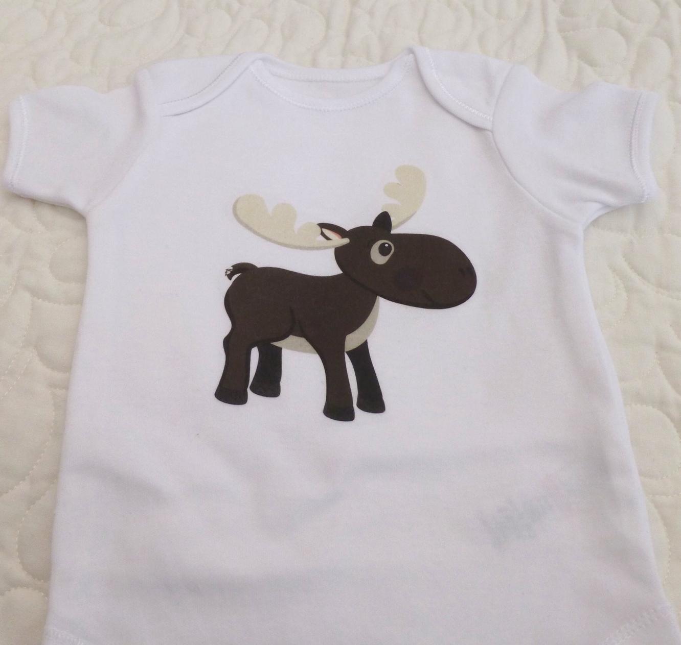

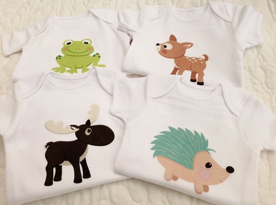

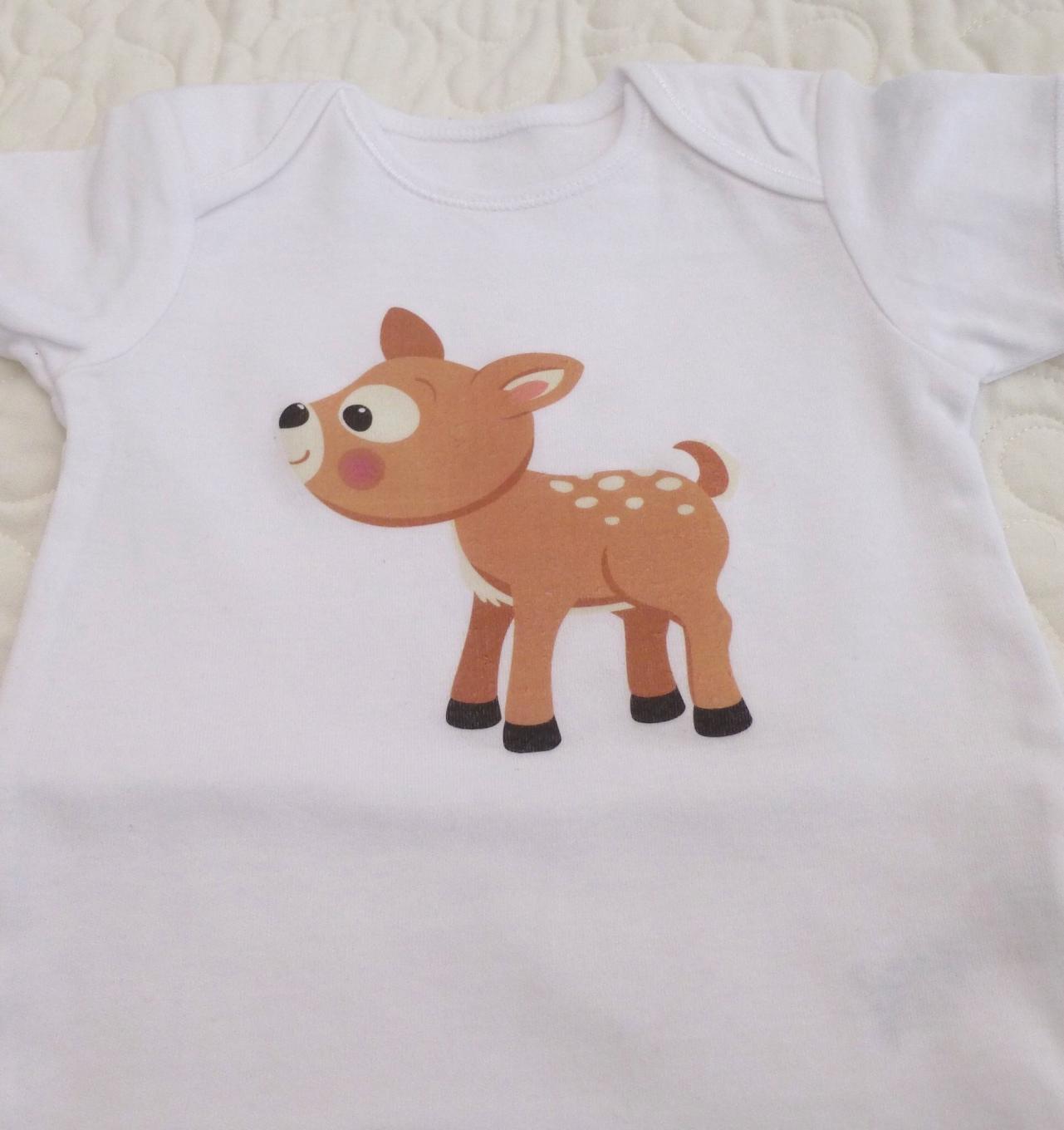

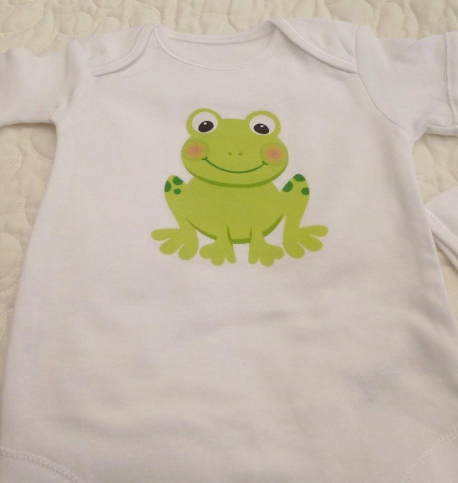

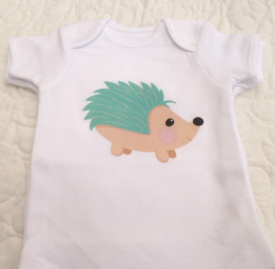

Forgot earlier, I got to play with my OKI 610 and TTC3.1 and had success. 8/9 pressure, 180C & 12 seconds.
I think my mistake was upping the temperature when I did not get the clean peel, reducing the time seemed to be the trick.
Anyway here is some picks. Nothing special just some baby grows. Cute though :rolleyes:
