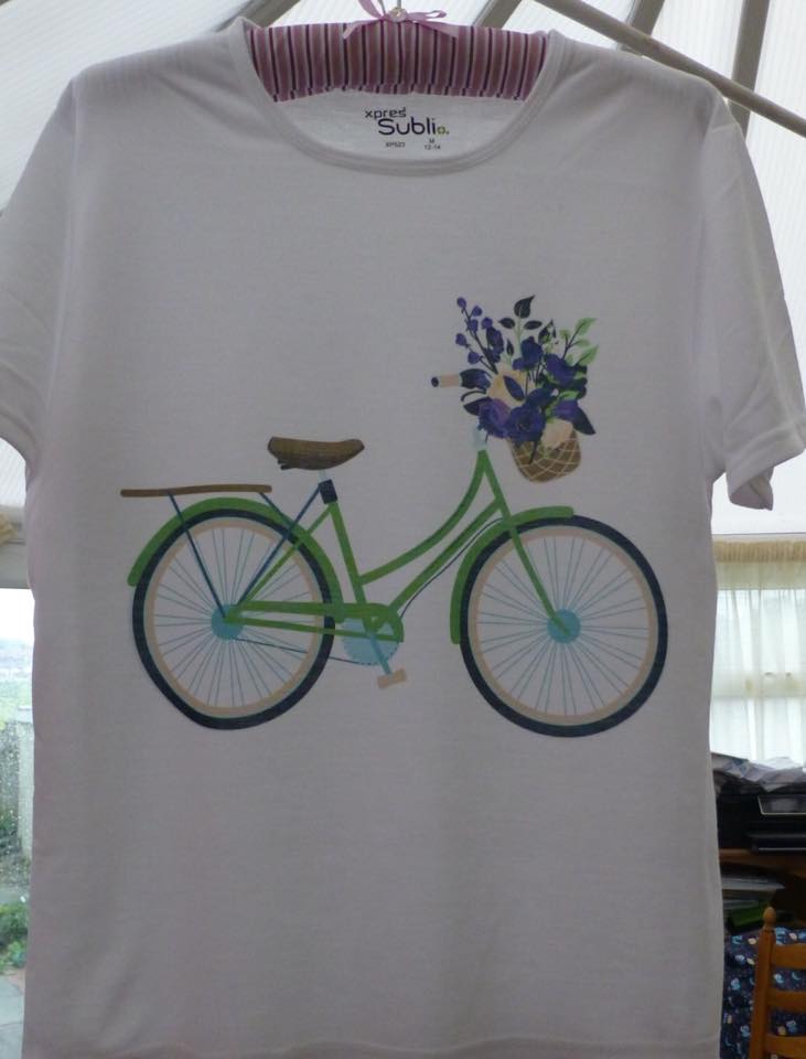

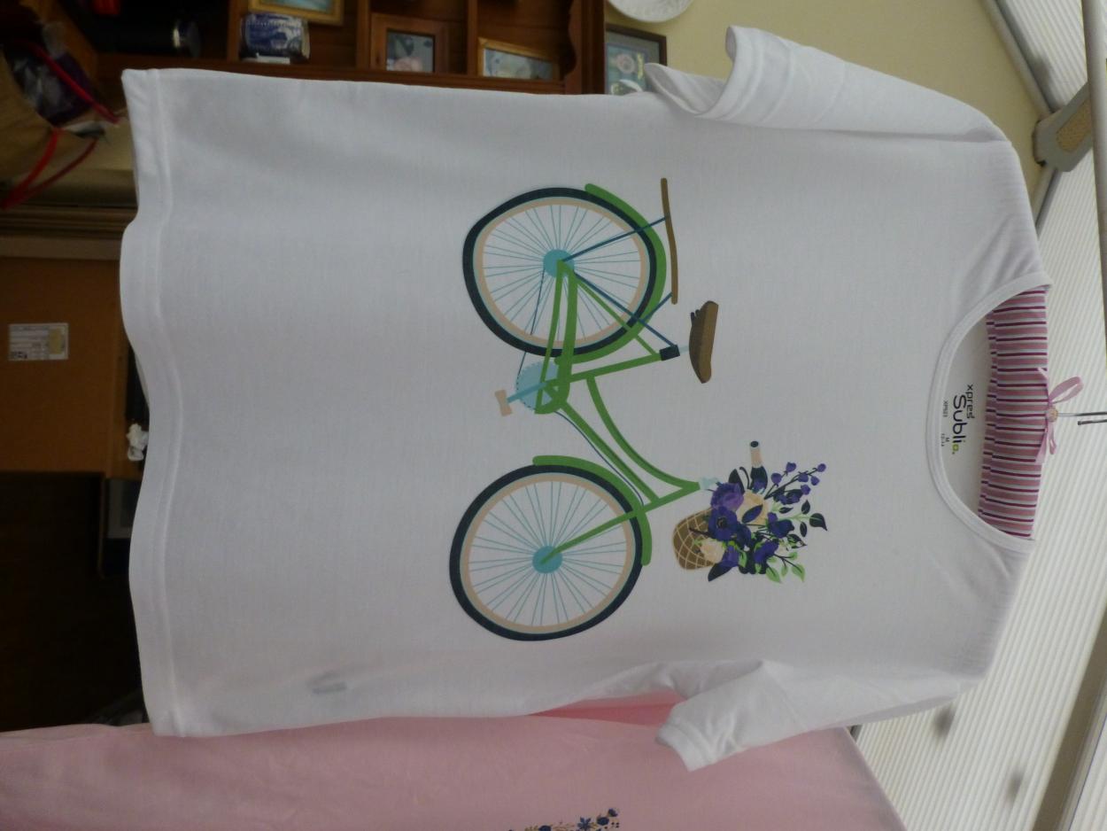

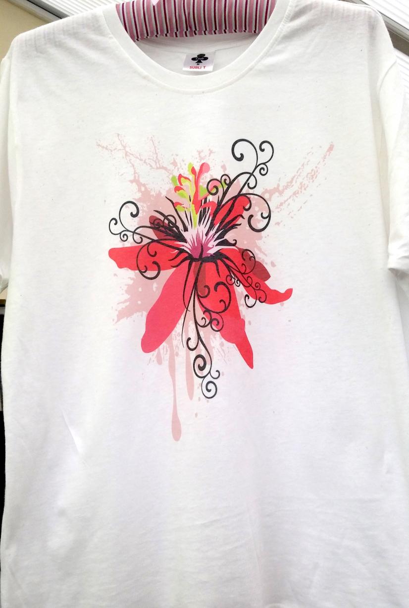

Here is a couple of photos
Oops will have to edit this post as I'm on my iPad ...LOL...photos are on my Mac.
The green t-shirt is a Vapor 100% poly and the white is a poly cotton mix 65%/35%. The white is from Elm and Elms that came in a sample pack i ordered, its very thin.
Now if anyone has any tips on TTC3.1. having a problem getting a clean peel. Kath

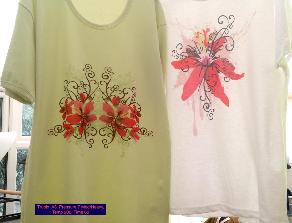

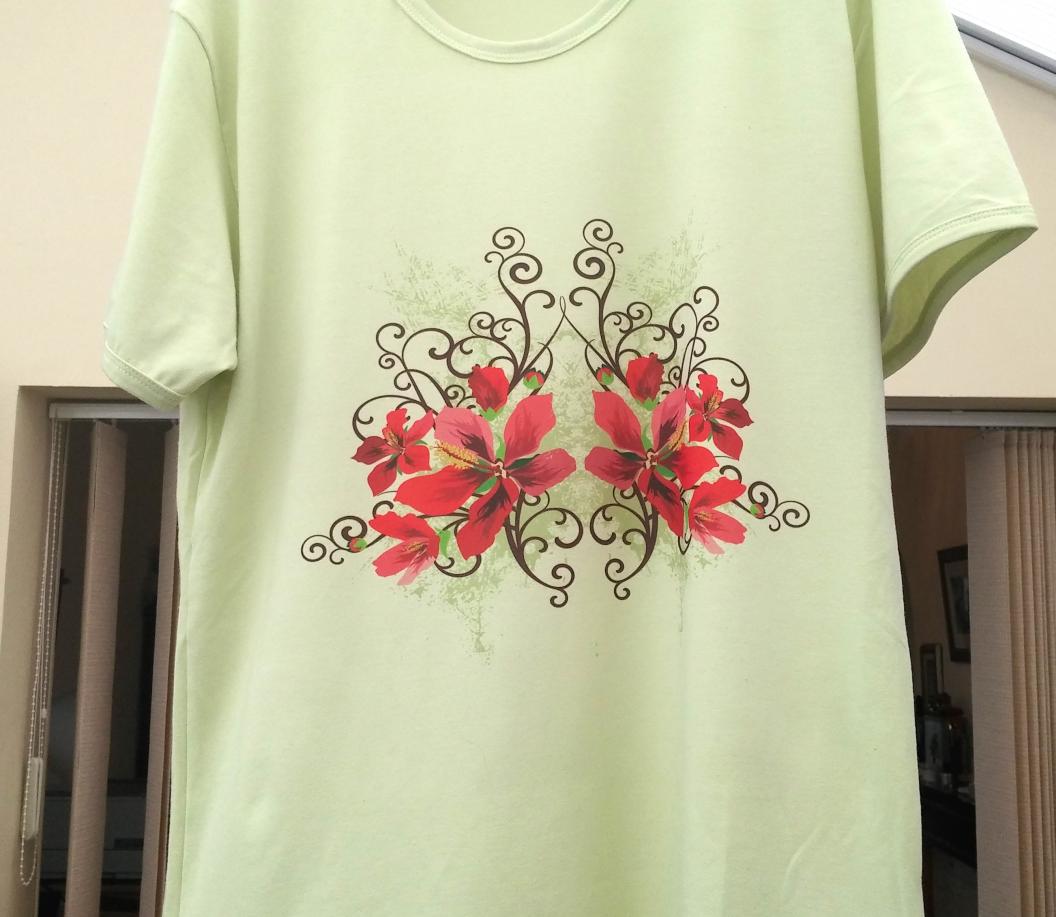

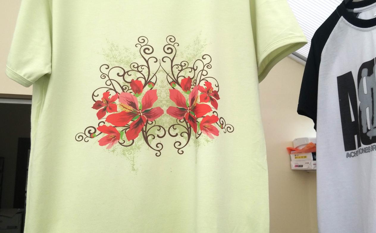

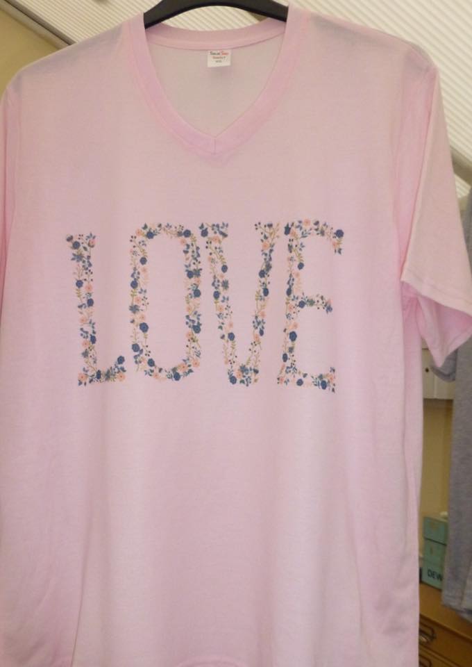

Here is a couple of photos of tees I did yesterday. not great shots as the light was bad.

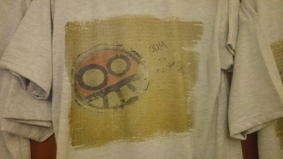

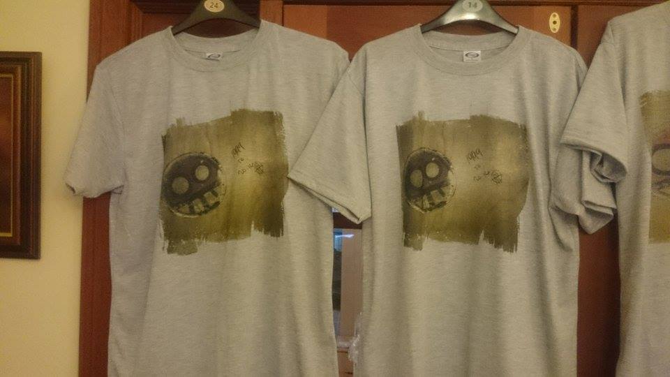

Not really my type of designs, but a friend of my son wanted this design which was drawn on a skateboard ramp by his friend putting on some T-Shirts. I played a bit in Photoshop until we found something he was happy with.
Delivered them today and glad to say he liked them.
