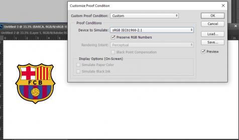

Re: Issues with Ricoh SG3100 DN
I think i may have solved the issue...
Would i be right in saying that if i select "SRGB iec 1966-2.1" in the proofing options, then the end print result should more or less match what i see on the screen? (providing i have my other print and colour settings set up correctly) - if i select Adobe 1998, the print ends up being too faded (as shown in example a few posts up)
I'm sure others have a great deal more knowledge than myself on this but you would need to convert your CMYK graphic to RGB first in Photoshop (before going anywhere near print options) and if the artwork is not as vibrant then you would have to get your designer to re-do the artwork in RGB mode. Everything printed onto paper is normally in CMYK but when it comes to sublimation then it needs to be in RGB.
