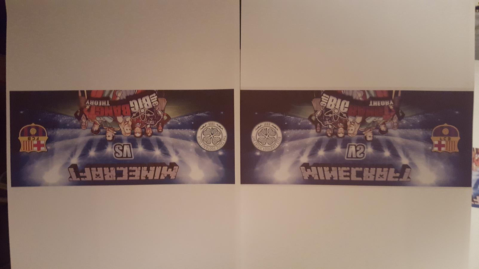

I have attached an image - the forward facing image is printing normally, the darker is using the powerdriver printing option
- vB_ID:3884
- 20160228_202412.jpg (86.9 KiB) Viewed 574 times

The print on the paper can have little correlation to the actual colours on the substrate once sublimated. So have you tried to press the paper yet onto the substrate? Also, what paper are you using?
Re: Issues with Ricoh SG3100 DN
Yes i have printed onto a mug and the output is that the reds are too dark (same as on reversed image i uploaded) - You can see on the normal forward facing print the reds are perfect. Using Truepix paper supplied by BMS.
