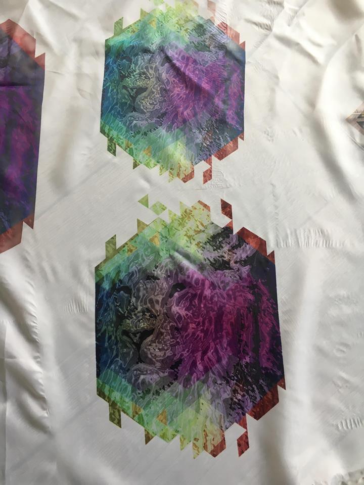

So received some samples today from alex @ inkexpress.
Changed some printer settings from advise alex gave and look at the difference in the results!
Colours are alot more vibrant and bright, image no longer looks faded, distorted and 2d.
And this is with no icc set up.
Printed on sample 100% polyester fabric for testing purposes.
Finally getting some were now , cheers alex

Great to see you are pleased Allan! Thanks for the great feedback!
Alex
