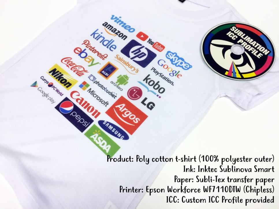

Re: Is the epson wf7110 ok for dye sub?
Not sure why the WF7110 gets so much hate, with the right inks and ICC profile they work brilliantly
research is key with any printer.
- vB_ID:5200
- WF7110_sub_test_8.jpg (89.39 KiB) Viewed 381 times
They aren't without their faults this is true, but again its down to the inks and also they PrecisionCore printing heads dont work well on refillable ink cartridges - I find they work much better on a CISS. I have never had a WF7110 block when using Inktec Sublinova inks. But each to their own, I was just surprised at the number of issues forum users have had with them.raydavies;132244 wrote:Yes, they're great until they clog! Threads galore about that.
Alex
Alex
