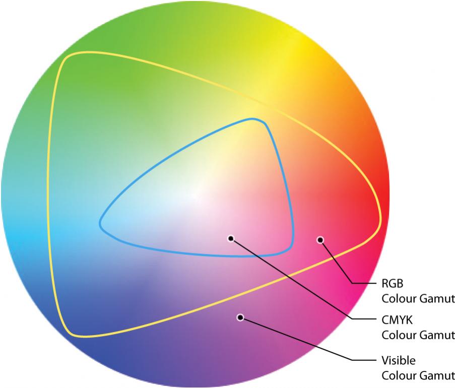

here is illustration that will help you understand what gamut is:
[ATTACH=CONFIG]1803[/ATTACH]

In Paul's diagram, there would be another triangle type shape showing the colours achievable with your sublimation inks which would be smaller and inside the CMYK one.
