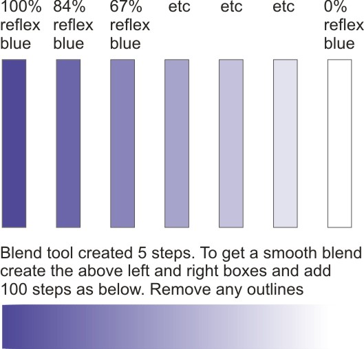

Hi Brett
Are you working in CMYK or Pantone?
Screen representation of blues are known to be different from what is printed due to the screen being RGB and presumably uncalibrated.
Personally I would try selecting a pantone colour that closely represents the colour you are trying to achieve. Draw a vertical rectangle with a 100% fill of that colour. Then where you want the gradual blend to finish copy and paste the same rectangle but this time give it a fill of 0% of the same pantone colour. Then use the blend tool to make 100 steps blending from the solid box to the white one. As they are both the same pantone colour Corel should give each box a percentage fill of the same pantone and hence you will not get RGB mixes confusing matters. Have a look at the attached which probably explains it better.

Ok guys, I have no idea of what a gamut is so feel free to explain. The blues all print as blues if i do block colour, it is just the gradient fade the purple creeps in. Almost like corel shifts the colour to purple before going to white. but not knowing the ins and outs I dont know.
The blend trick from social giraffe did the trick. i was then able to shrink that and put it in the left of the badge template and prints like a charm.
