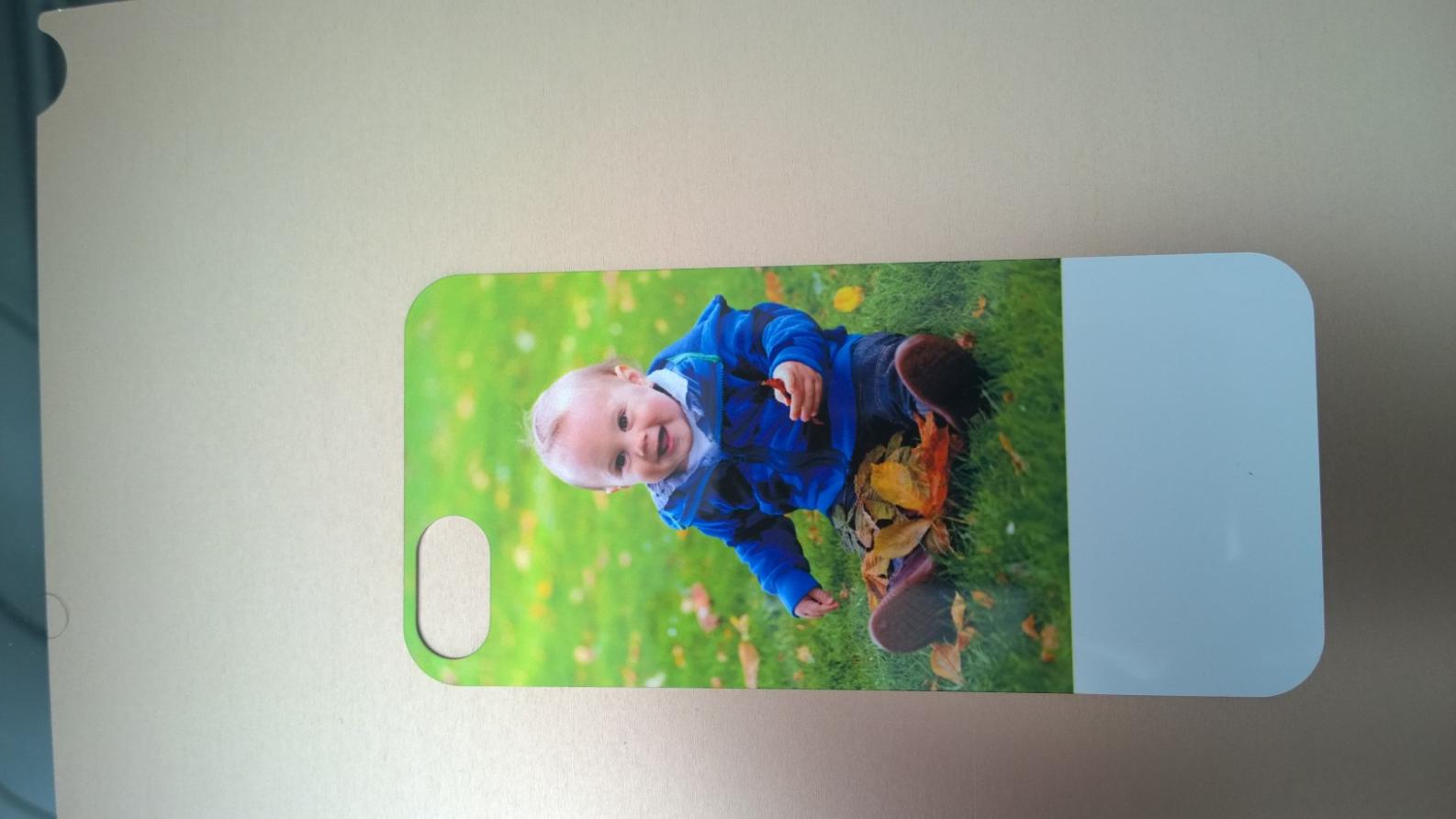

photo's are coming out ok it just seems to be when I select colours when typing text (from the colour pallet on the right or typing rgb code)
Photo of insert does look dark but that's as i'm just using my phone camera
- vB_ID:2698
- autumn-89183_1920.jpg (92.35 KiB) Viewed 213 times
- vB_ID:2697
- WP_20140428_15_40_35_Pro.jpg (90.45 KiB) Viewed 213 times
