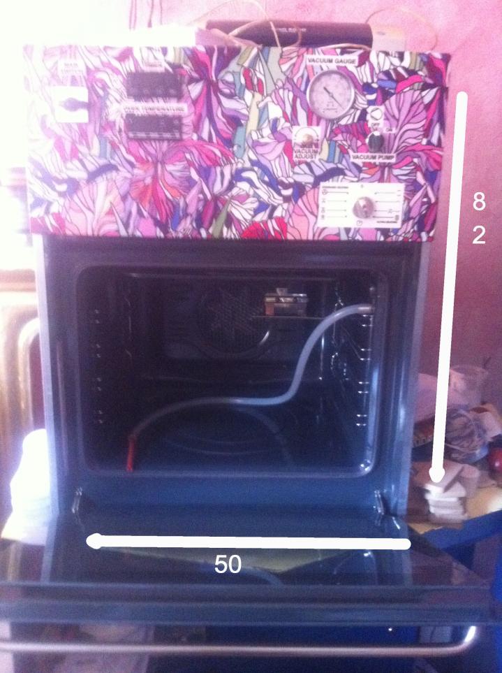

membrane
Posts: 50
Joined: 14 Jul 2013, 23:35
Re: Trying to find a solution for iphone blanks corners... We can do it! :-)
Post by membrane »
I don't use film with the membrane only paper, I tried to use it that way but too many problems. The film would bubble when I lowered the membrane. I could never get a good solid print.
This is the machine to what I have to do film only (my machine has different graphics on front)
[ATTACH=CONFIG]2872[/ATTACH]
I also have the same red machine everyone else has with the membrane to do paper.
