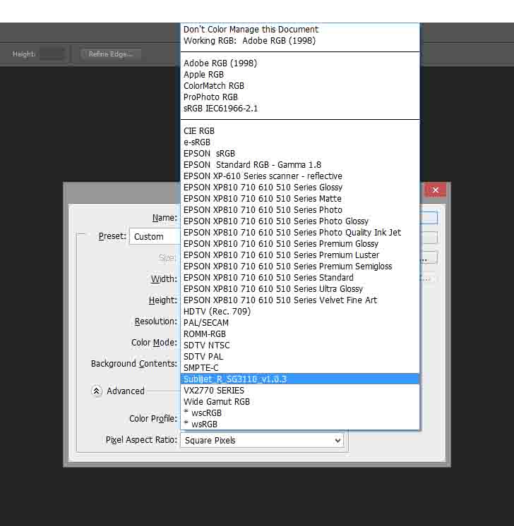

When I create a new canvas in photoshop I am asked what profile I want to use, see below.

Re: Colour Printing Problems
There are different colour profiles for different things, and they aren't interchangeable
You display/monitor has an ICC
Your printer/ink has an ICC
Your scanner/camera have an ICC
And the workspace in Photoshop has another.
You are trying to use your printer/ink ICC for the Photoshop workspace, which is why you're having problems.
I would advise using Adobe RGB 1998 for your workspace in Photoshop

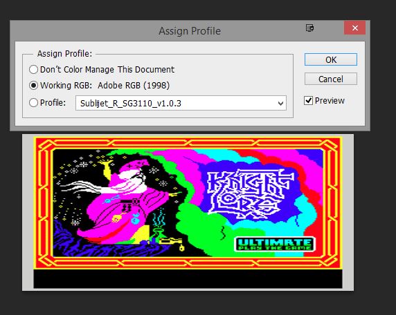

I just followed the instructions again from Sawgrass on printing from Photoshop using RGB 1998 and this is the resulting image.
set your document LAWAYS as Working Rgb: Adobe Rgb
when this pop up
vB_ID:3183
vB_ID:3183
always pick working rgb: adobeRgb
and then
in printing window you pick: let photoshop menage colors
and pick sublet from there.
it will work.

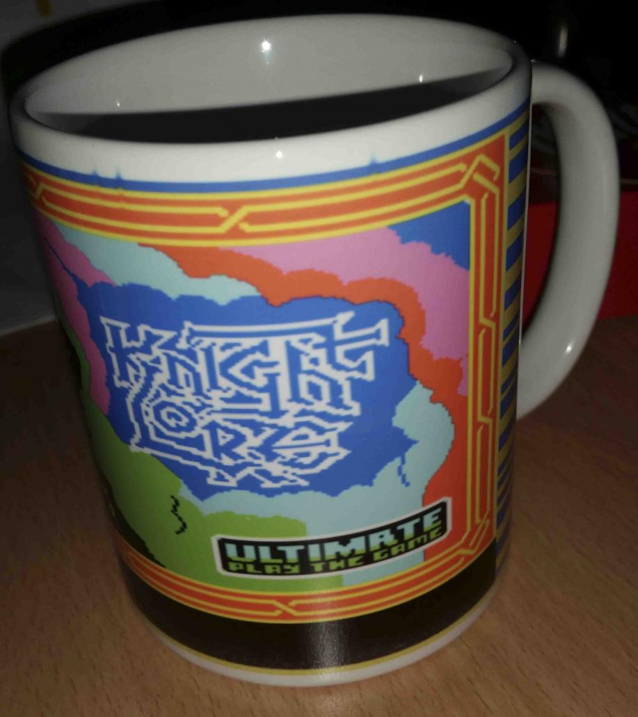

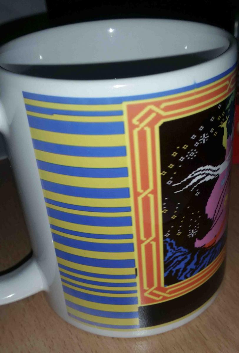

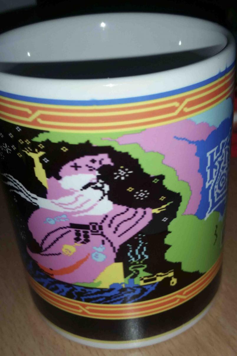

Photos of the pressed image, what should be magenta is printing pink and the red is more orange.

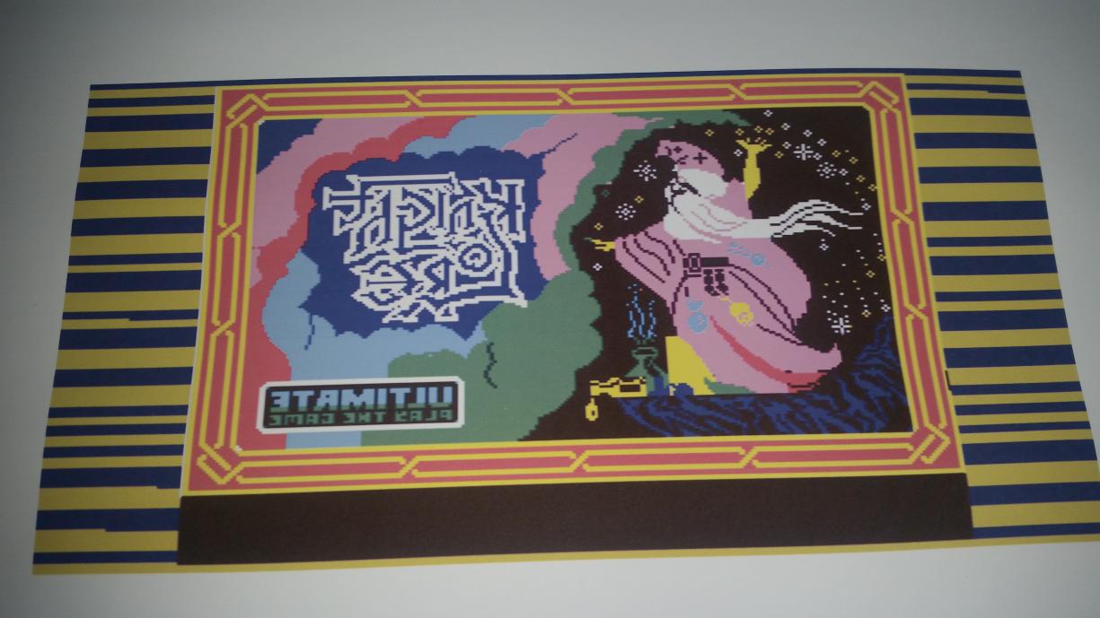

To get the colours near as dammit I am not using the Sublijet profile as this makes the colours look washed out (shown in the photo of the print)
Instead I tried using CIE RGB and the above pictures are the result.

You can not use the print on paper as your guide without experience. When you press the the image the print will be different to that which appeared on the paper.
If you expect the really bright pinks etc to glow like they do on your screen...they won't.
The colour range in sublimation is reduced, among many other factors.
