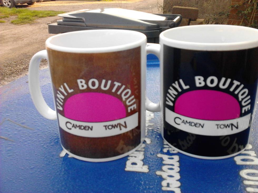

I've got a sheet I printed nearly 10 hours ago and it is still not completely dry. When I pressed one, the colours were great, unfortunately because it was not totally dry, there were smudges.
I'm going to give up on this lot. Longforte are sending me some of their Ultra dry paper to try and I'll be ordering some more Trupix today. I only got it to simplify my ordering by trying to get what I needed in one delivery.

That's what I thought, but the mug on the left was the result. Mug on the right was using a slightly damp print.

Time or temp is wrong then, mug press or oven ?
